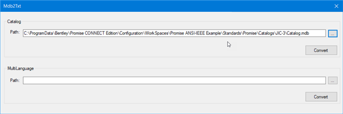

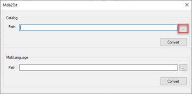

3. Open MDB to TXT conversion tool. Locate Mdb2Txt.exe in folder "C:\Program Files\Bentley\Promise CONNECT Edition\Promise\Assemblies"
4.
Select desired Catalog.mdb file using browse button.
5.
Click Convert. Then Click OK.

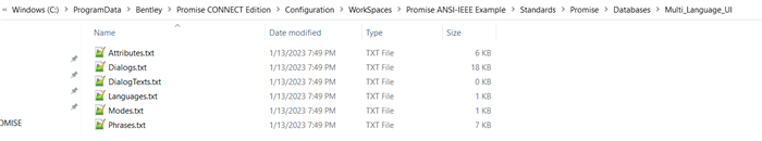

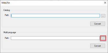

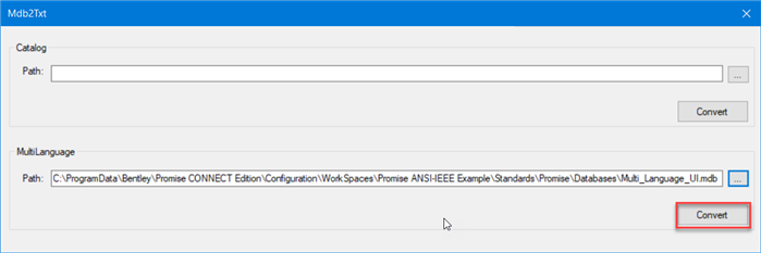

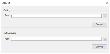

8. Select desired Multi_Language_UI.mdb file using browse button.
9. Click Convert. Then Click OK.

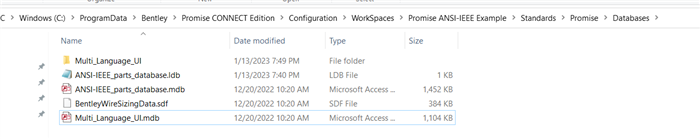

10.
Verify conversion. Open Databases folder using Windows explorer. Verify creation of new folder and txt files.

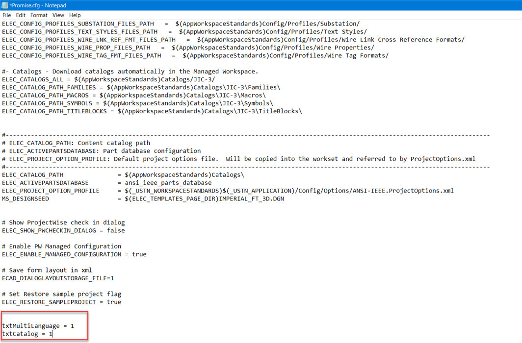

11. Add configuration variables to one of the three *.cfg files mentioned in beginning of this document.
Use below Text to Copy into *.CFG file
txtMultiLanguage = 1
txtCatalog = 1
Example edit made to Promise.cfg file.

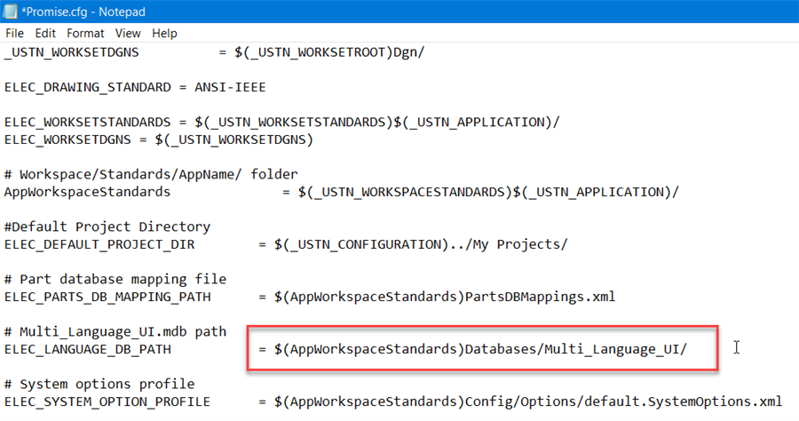

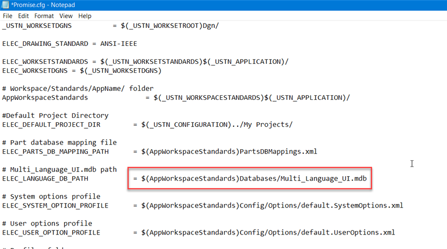

12. Change ELEC_LANGUAGE_DB_PATH variable value. This variable resides in Promise.cfg.
Set this variable’s value equal to the folder path of your Mutli_Language folder.
Copy below text to Promise.cfg file to replace with existing cfg as highlighted in the below reference images.
ELEC_LANGUAGE_DB_PATH           = $(AppWorkspaceStandards)Databases/Multi_Language_UI/
Before Edit
After Edit
Note: If there is a need to modify the “Multi_Language_UI” folder, then update the configuration variable with correct details. Example if the folder is renamed to “Custom_ Multi_Language_UI” then the configuration variable should be set to
“ELEC_LANGUAGE_DB_PATH     =   $(AppWorkspaceStandards)Databases/Custom_Multi_Language_UI/”
