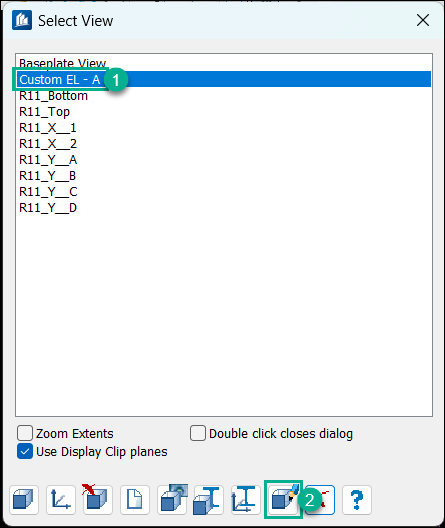

A. From Select View dialog:

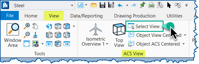

1. Open the   Select View tool located at View > ACS View > Select View.
2. In the Select View dialog, select the Workframe that you want to edit the properties and then select the   Edit Workframe button.

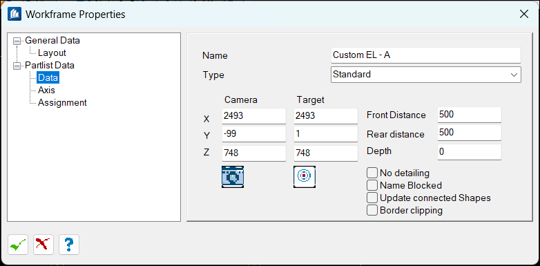

3. The Workframe Properties dialog opens, here one can edit the required properties. (Refer the image from Step C-1).

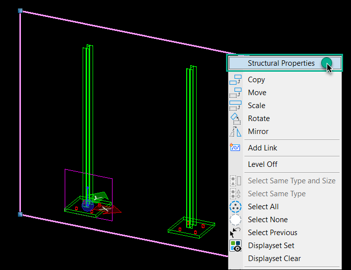

B. From Context Menu:
1. Select the Workframe grid, hold right click and from the context menu left click on Structural Properties.
2. Now, the Workframe Properties dialog opens for editing. (Refer the image from Step C-1).
