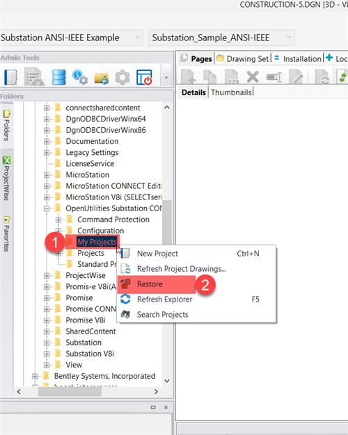

1. In Project Manager in the Left Folder Tree Browse to the Folder in which the project needs to be restored depending on where its located in Local Machine or Network Folder or ProjectWise.
2. Right Click on the folder and select Restore

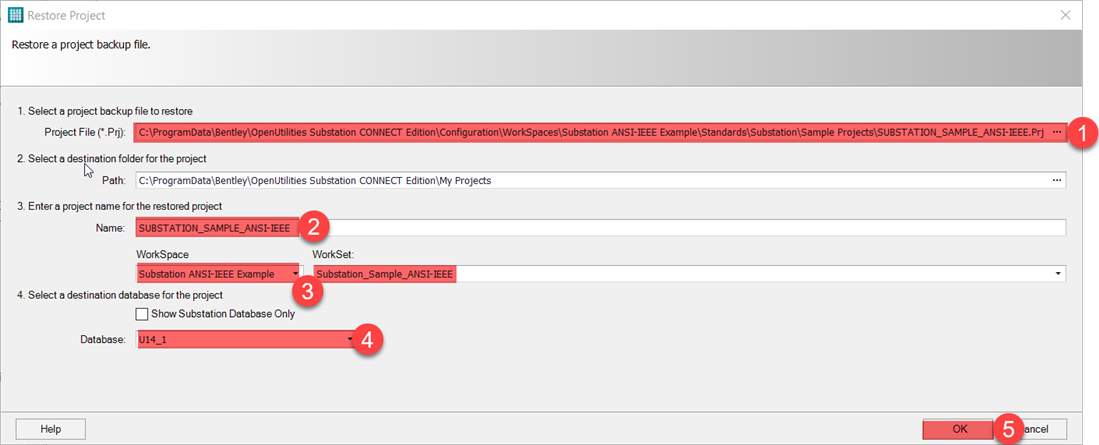

3. Select the location of the Project Backup file (*.prj) using the 3 dots on the right of the Project file. The specify the Name of the project that needs to appear after restoring the project. Select the WorkSpace and WorkSet the project needs to be associated with. Select the Database in which the project needs to be restore and click OK.
