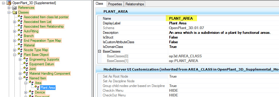

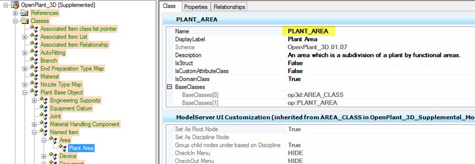

  1. Launch class editor and load OpenPlant_3D schema.
  2. Supplement it with following schemas:
    OpenPlant_3D_Supplemental_Modeling
    OpenPlant_3D_Supplemental_Model_Server

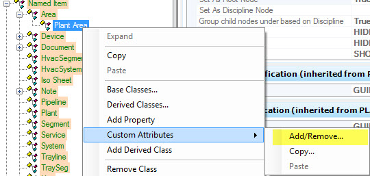

  3. Go to PLANT_AREA class.

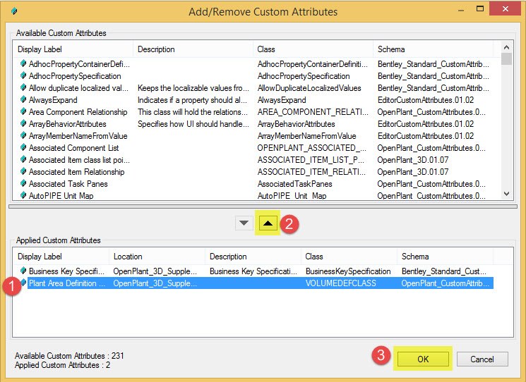

  4. Right click on PLANT_AREA class and select Add/Remove custom attribute as shown below:

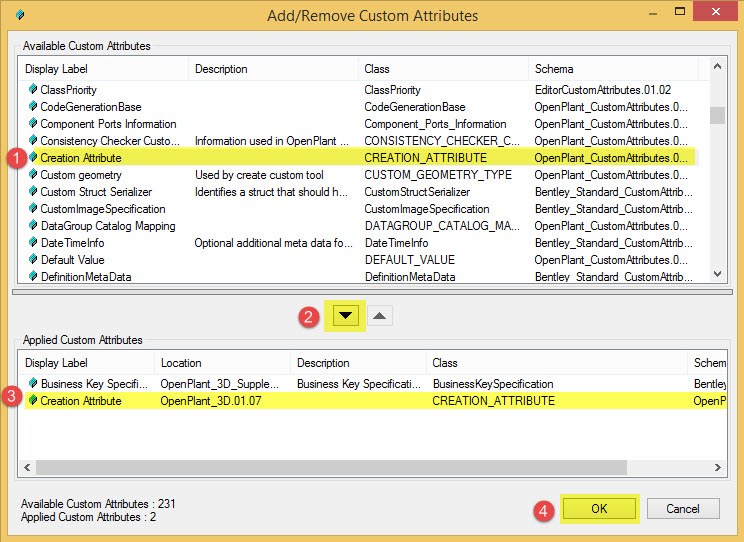

  5. Remove 'Plant Area Definition' custom attribute from this class.
  6. Again right click on PLANT_AREA class and select 'Add/Remove' custom attribute option as shown in step 4.
  7. Add 'Creation Attribute' and click OK.

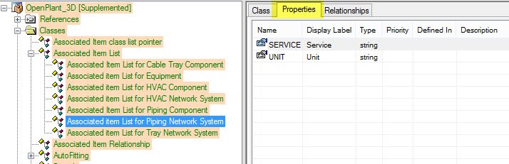

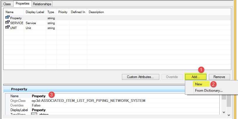

  8. Now go to ASSOCIATED_ITEM_LIST_FOR_PIPING_NETWORK_SYSTEM class and switch to properties tab.
  9. Click "Add" button and name the property as 'PLANT_AREA'.

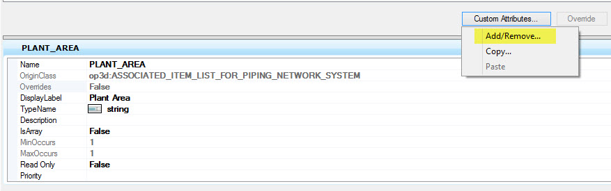

  10. Click 'Custom Attributes' button and select 'Add/Remove' option.

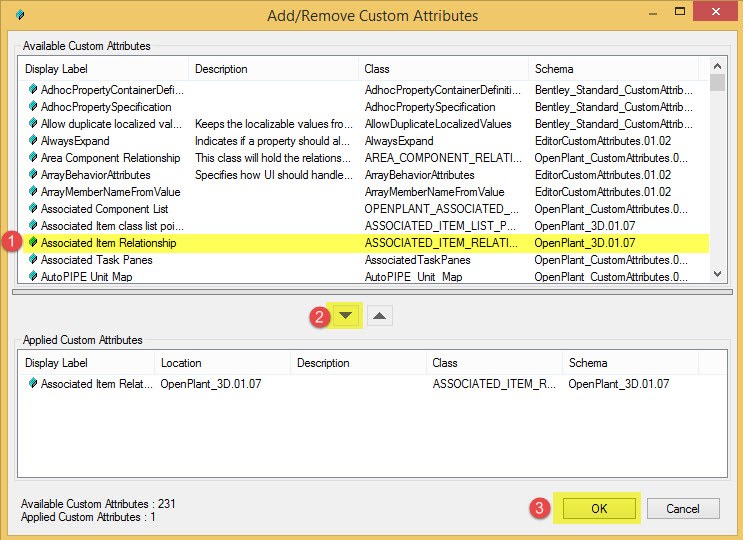

  11. Add 'Associated Item Relationship' custom attribute.

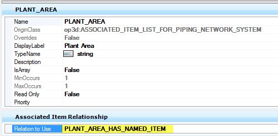

  12. Add "PLANT_AREA_HAS_NAMED_ITEM" relationship in Relation to Use field as shown below.

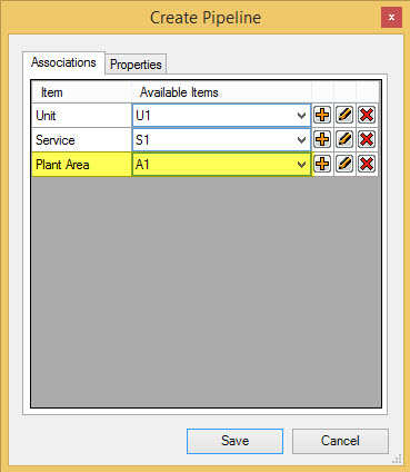

  13. Save the changes and verify the results.
