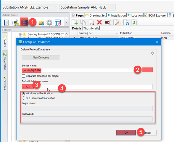

1. First Determine the SQL Server that you are planning to use with OUS. Then Create a New Project Database on the Server for OUS using the steps in the below Wiki Link.
communities.bentley.com/.../creating-and-updating-the-project-database---substation-ce
2. Then configure the new Database in OUS if not done already from Configure Database under Admin Tools >> Select/Specify Server name, database name and Authentication and Click OK
Important Note: The database configuration for default database is a per user settings and admins can deploy the file "DBSettings.xml" located in "C:\ProgramData\Bentley\OpenUtilities Substation CONNECT Edition\Configuration\Datasets\Substation\Config" to user machine after following the above steps.
3. Restore the Project using the Project Backup and select the new Database for Restoring the Project. Refer the below Wiki Link for Steps to Restore Project.

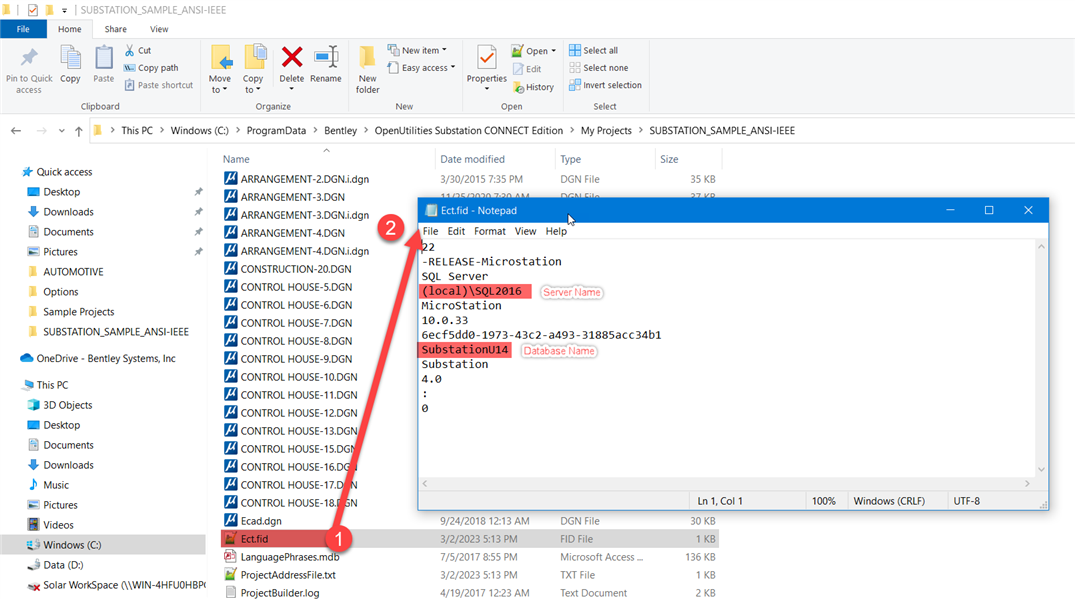

2.  The Details related to Server Name and Database name is stored inside each project folder inside ECT.FID file which is used by OUS to establish connection with the Project. Hence if there is a Server Name and or Database Name change for the new Server location then it needs to be updated in all the projects ECT.FID file.

1. Backup the Database from the old SQL Server.
2. Restore the Database on New SQL Server.
3. Then configure the new Database in OUS if not done already from Configure Database under Admin Tools >> Select/Specify Server name, database name and Authentication and Click OK
4. If there is change in Server and Database name from the Old Server to the New Server then the ECT.FID file needs to be updated with the New Server Name and Database Name. The ECT.FID file is usually present inside the Project Folder where the project is stored.
