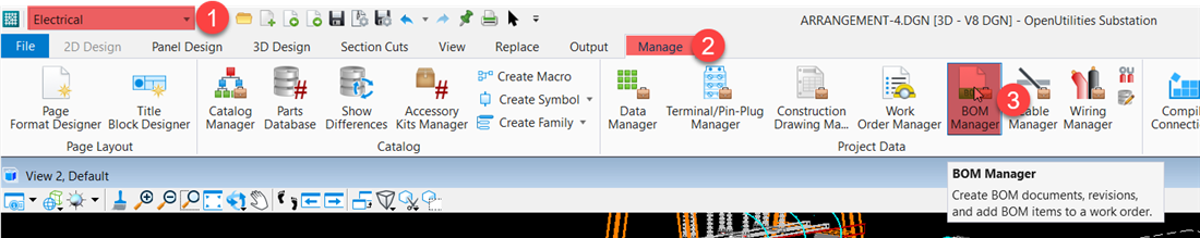

1. Click on Manage >> BOM Manager to open BOM Manager dialog.
