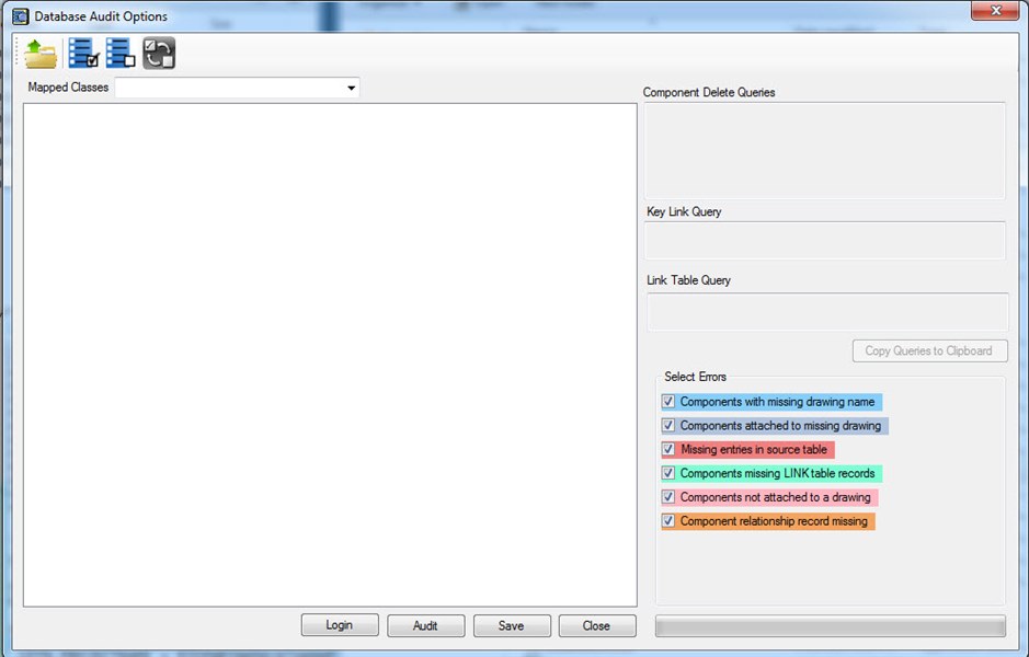

Installed with the OpenPlant PID application is a tool named DBAUDITTOOL.EXE. This file is located in the following file folder:
C:\Program Files (x86)\Bentley\OpenPlantPID (SS5)\OpenPlantPID
Shown below is the Database Audit Tool:

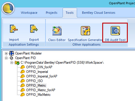

Please note this same tool can be launched through the OpenPlant Project Administrator SS6 version:

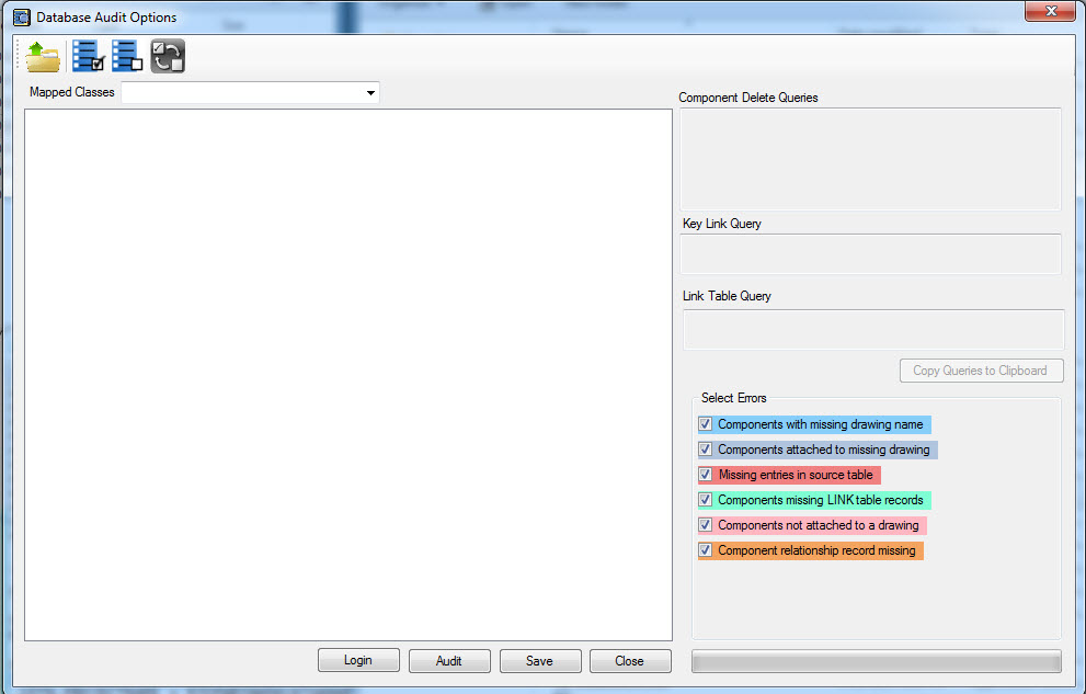

Once the tool is open follow the steps below to begin the audit process:
