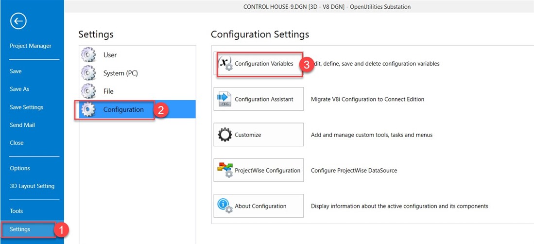

The user get the below error message when trying to attach a Raster Image using Raster Manager. The user might be trying to attach *.Tiff. *.CIT for example. This Wiki Article will help user resolve the issue for the below error message.
1. Open any Project Page and then Go to File >> Settings >> Configurations >> Configuration Variables.
2. Search for and filter for the variable “MS_RASTER_FACTORYSCANON” and change the Value to “TRUE”.
