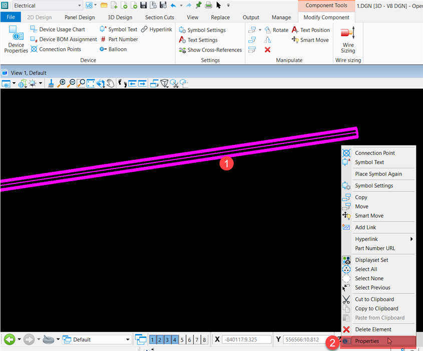

2. Select the Cable and Right Click >> Properties.

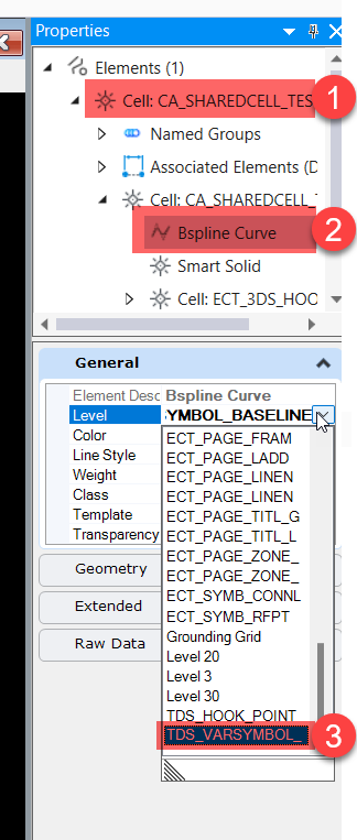

3. In the Properties dialog select Cell: "Symbol Name" >> Cell " Symbol Name" >> Bspline Curve. Then change the level to  "TDS_VARSYMBOL_BASELINE".

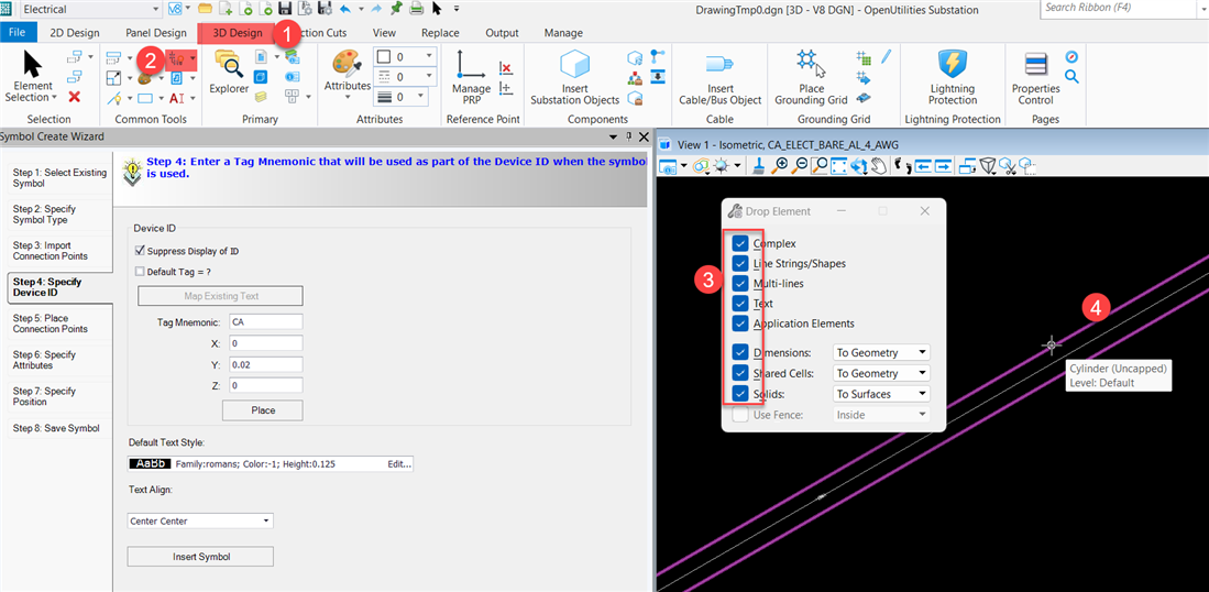

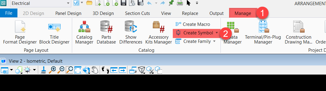

1. Click on Manage >> Create Symbol

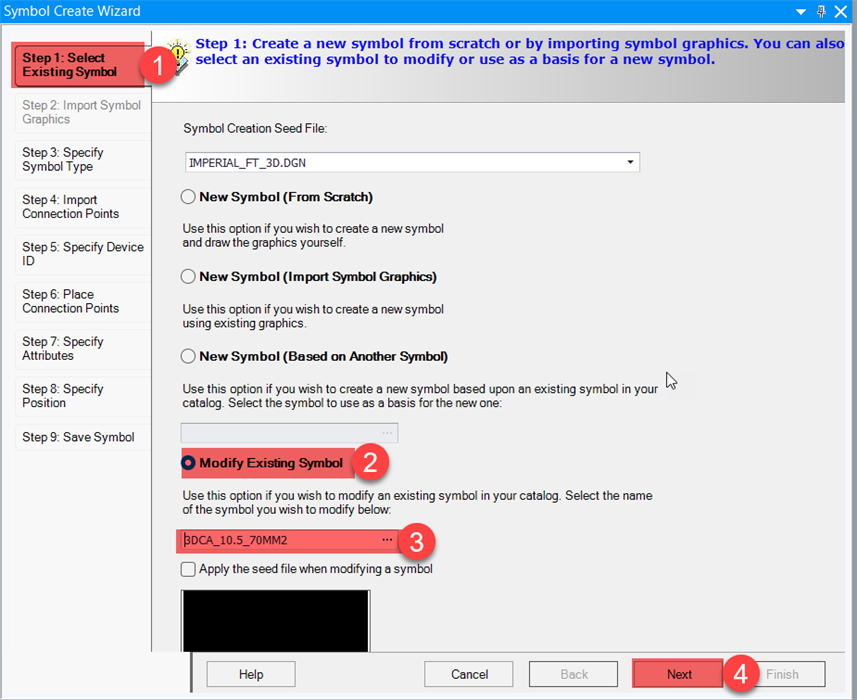

2. Select "Modify Existing Symbol" in Step 1 and select the 3D Cable symbol using which the issue is being faced. Click next until the 3D Cable symbol visualization is opened.

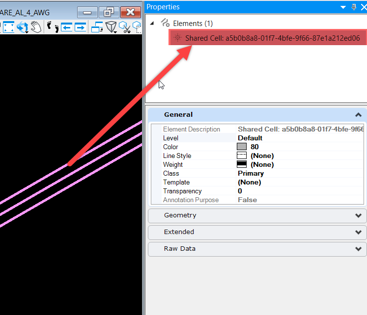

3. Click on the Cable and right click Properties. Check if the properties displays it as Shared Cell under elements.
4. Click 3D Design >> Drop Elements >> check all the options >> select the 3D Cable symbol by using Left Mouse Click.
