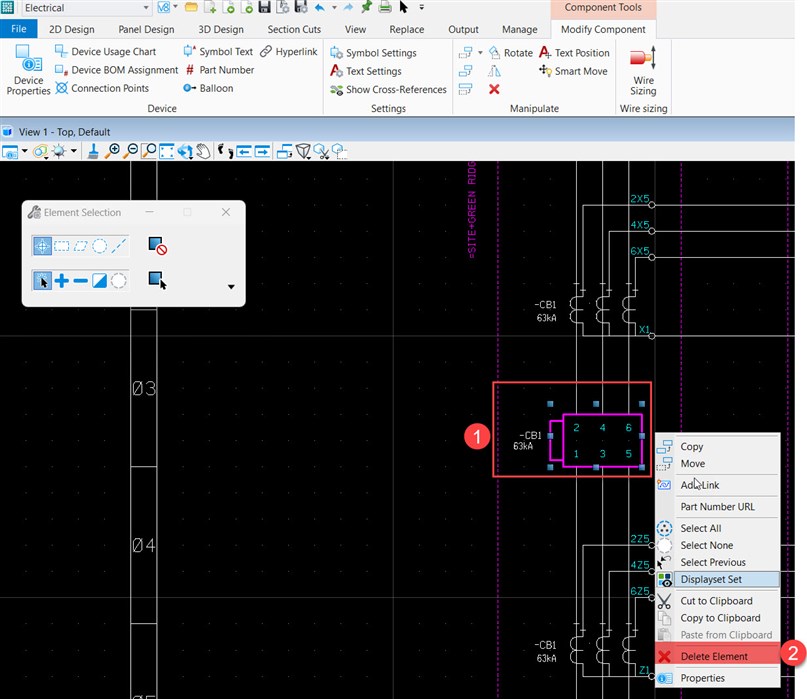

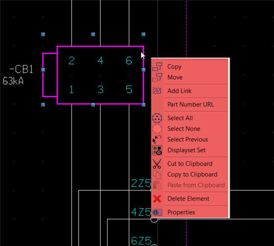

1. Delete the Non - Intelligent Symbol.
1. Open the Project Page where the issue is being faced.
2. Select the the Non  Intelligent symbol graphics >> Delete Element.
3. Now Close the page and Check-In the project page.
