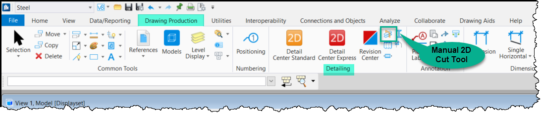

1. Under the Steel workflow, navigate to the Drawing Production > Detailing > Manual 2D Section.

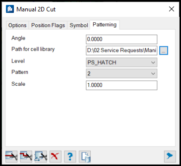

2. In the Manual 2D Cut dialog under Options tab, unselect any Detail Styles. This will allow the Patterning tab to be available.
3. If you prefer patterning styles set in a detail style, choose any user-defined detail styles available. Please follow this another Wiki on how to set Patterns in a detail style.
4. In the patterning tab, set the parameters ranging from angle, cell library location, level, patterns to scale.
