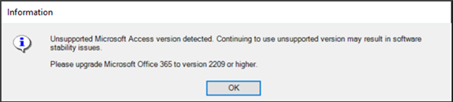

If the user already has a version of MS Office 365 which is older than the above versions they will get the below Error Message when they install Promis.e CE or OUS indicating that they are running an older version and they to upgrade the version to more latest or compatible version.
Note: Before Uninstalling Access Database Engine from your machine please confirm with IT Department if it would impact any other existing applications on the machine.

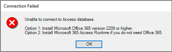

If the user tries to install OUS or Promis.e CE with no Microsoft Office or Microsoft 365 Access Runtime they will get below error message.
