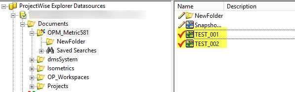

When we launch OpenPlant Modeler from desktop, it is easy to open multiple instances. However, if user is working is launching OpenPlant Modeler by opening the file from ProjectWise then it asks to check-in the file which is already open.
  1. Launch ProjectWise and login to the datasource.
  2. Open the file to launch OpenPlant Modeler.

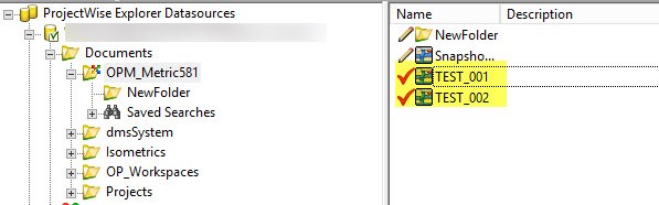

  3. To open second file, press SHIFT key on keyboard and open the second file. This will open the second instance of OpenPlant Modeler.
  4. You will see that both files have been checked out from ProjectWise.
