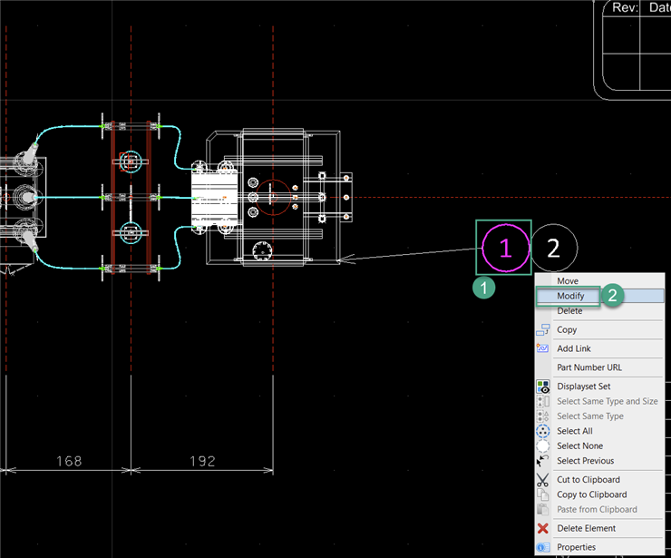

The user when placing the Balloon Callouts they might accidentally select the Wrong Balloon Callout Style. In this article we will see how to change the Balloon Callout Style after it has been placed on the Drawing.
1. Select the the Balloon Callout and Right Click >> Select Modify.

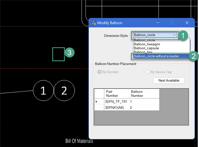

2. In the Modify Balloon select the required Balloon Style using the Dimension Style Drop Down List. Then give a data point by left click on the drawing.
3. If the Balloons need to be moved the Balloon Style has been changed, then Right Click on the balloon and then
