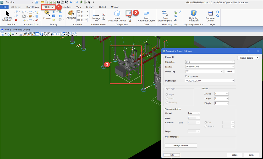

This article will help users to replace Part Number for a 3DLayout symbol and the replace the already placed 3D Layout symbol with new symbol according to the new Part Number if they are different.
1. Click on 3D Design >> Update Substation Setting >> click and select the Object that needs to be updated.
2. Now in the Part Number field in Substation Object Dialog select the new Part Number that needs to be updated with.
