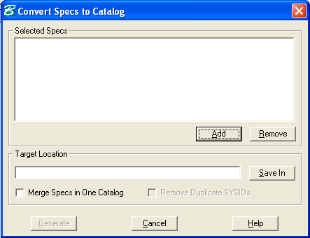

This will load the 'Convert Specs to Catalog; dialog'.  Here there are a number of options that can be done during the conversion process.
The top have of the dialog is were the specs will be listed once they are selected.  This is done by clicking the Add button.  Any spec that has been added can be also removed from the selection by selecting it and clicking the Remove button.
The bottom have of the dialog includes the location for were the catalogs will be stored along with the options 'Merge Specs in One Catalog' and 'Remove Duplicate SYSIDs'.  To select a location, just hit the 'Save In' button to bring up the 'Browse for Folder' dialog and select the folder that you wish to place the catalogs.  NOTE: Don't place the catalogs in the same location as the specs, the program will name the catalogs the same name as the spec that they are created from so doing so will cause an error in the program.
The 'Merge Specs in One Catalog, does just what it says.  It will take all the specs and create one master catalog out of all of them instead of making one catalog for each spec as the program does when this option is unchecked.  The 'Remove Duplicate SYSIDs will only become available  the Merge option is selected.  This will help remove any duplicate components from the merged catalog.  An example of this would be if you have two specs, Spec A and Spec B, and both have the same 6" pipe that came from the same original catalog.  When generating separate catalogs, this component will be placed into both new catalogs.  But, when merging the catalogs into one, this would place to copies of the same component into the single catalog, which isn't needed.  This option will remove the duplicate from the newly  created catalog keep this to only a single copy.  Another ting to note is that when the 'Merge Specs in One Catalog is checked, the 'Save In' button will change to a 'Save As' button and the Generate button will be grayed out.  Clicking the 'Save As' button will allow to give the new catalog a name which it will need before the 'Generate' button will become active again.
Once all the options are set, pressing the Generate button will run through the process.  Depending on the options set in the dialog, it will either create a number of new catalogs into the designated folder or a single file of the specified name in the selected location.
