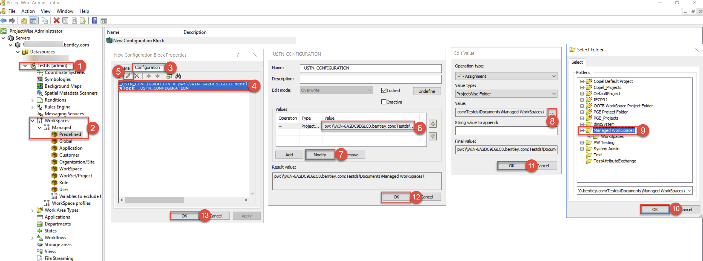

1. Configuration Setting Block:
This very Important setting that needs to be updated as this setting helps OUS with details on where to search for the Managed WorkSpace. This changed need to be done in ProjectWise Administrator. Refer to the below Wiki Link's "Create a Predefined level CSB called Substation_CE_Configuration " section and modify the existing path to the new path.
communities.bentley.com/.../how-to-create-configuration-setting-blocks-for-linking-with-projectwise-managed-workspace-for-projectwise-integration---openutilities-substation

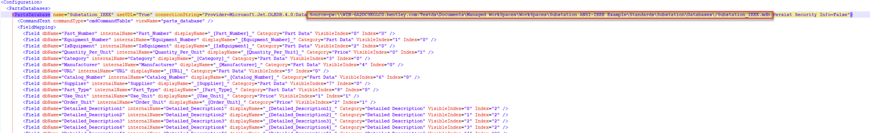

2. Parts Database Mapping
Note: This setting will only impact the environments where MDB file is used to store the Part Number data. If SQL Database is used to store the Part Number data then the user will not be impacted.
This can be accomplished by Remapping the Parts Database MDB file. For steps refer to the below Wiki Link.
communities.bentley.com/.../how-to-create-parts-database-path-using-mdb-file-in-promise-connect

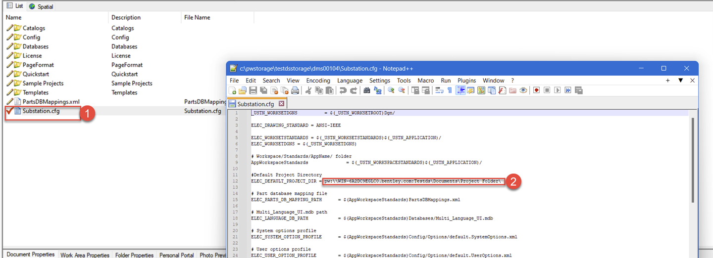

This can also be updated manually by modifying PartsDBMappings.xml file in the managed WorkSpace using Notepad or Notepad++. The copy the path where the file is located and paste it along with MDB file name for the Parts Database being used in the WorkSpace. Refer to the below image for details.

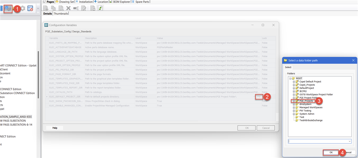

3. Default Project Path:
This path is default location where OUS project will be created or restored by default unless the user changes it manually.
This can be changed in the Substation.cfg file or Configuration Variables by Copy and Pasting the new Default Project folder path.
Modifying Substation.cfg file
Updating Configuration Variable

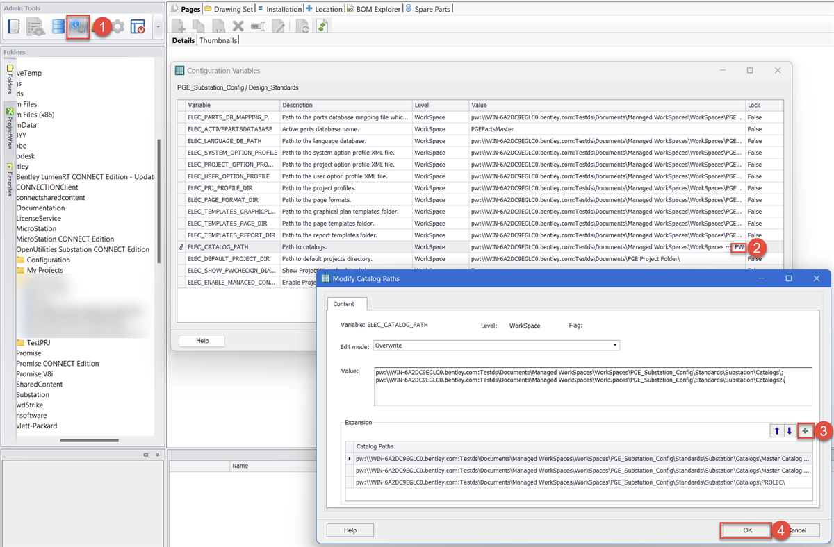

4. Catalog Paths
Usually user might have Catalogs in Multiple paths this can be updated by using adding the new path for the Catalog on the new Server using the Configuration Variables.
