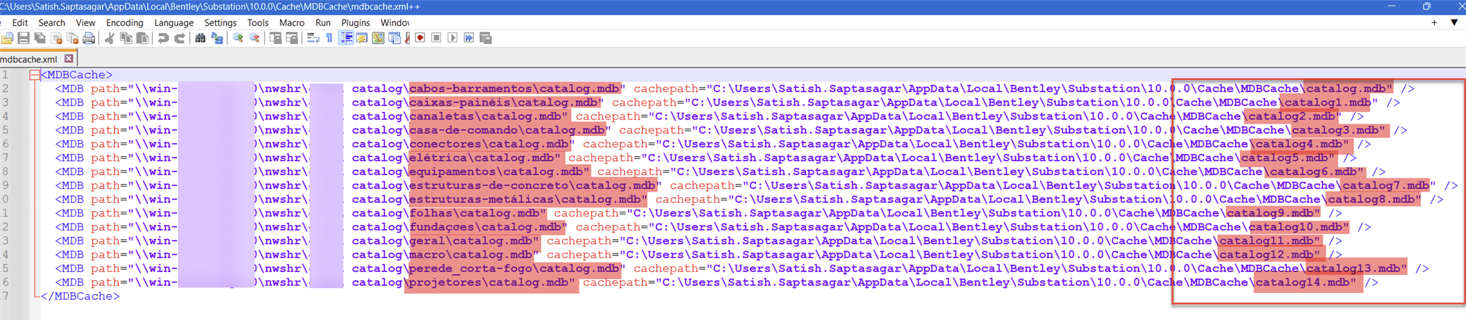

When the user have the Catalogs stored on the Network Location instead of the Local machine, OpenUtilities Substation creates a copy of the Catalog.mdb on the local machine of the user. In this Wiki Article we will learn where these file are usually located and how to find the which Catalog.mdb is associated with which Catalog.
1. To locate the Catalog.mdb cache files go to the location "C:\Users\(Current user name)\AppData\Local\Bentley\Substation\10.0.0\Cache\MDBCache"
2. Since the Catalog names are numbered open the mdbcache.xml in notepad for details of the What name of Catalog.mdb from in the cache folder is associated with which Catalog on Network location along with the Path.
