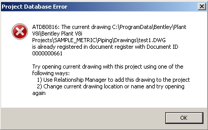

The AutoPLANT error "The current Drawing XXXXXX is already registered in the document registry with document ID XXXXX" (seen Below) occurs when the drawing's name and Doc ID differ from drawing name and Doc ID in the database. The error can be easily corrected.

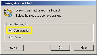

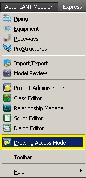

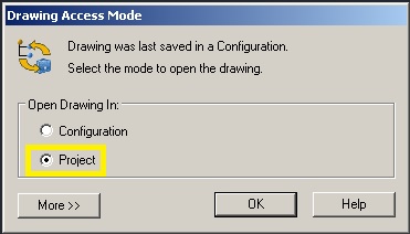

  2. Open AutoCAD and turn on Drawing Access Mode by going to "AutoPLANT Modeler>Drawing Access Mode" like in Pictures below
      or
    Note- Activating Drawing Access Mode will open the project selection prompt every time AutoPLANT is started
  3. Open the drawing from AutoCAD and Start AutoPLANT Modeler
  4. When prompted for a project: chose Configuration. Then choose the Project which has the same units as the drawing.

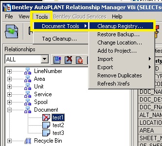

  6. Open RelationShip Manager
  7. Delete instances of the drawing out of the project to remove drawing data from the project database
    If Registry is clean then simple delete this document
    Moving the drawing to a different location in step 1 will prevent it from being deleted in this step.
    When deleting the drawings: ensure that the drawings deleted are duplications not a different drawing with the same name.

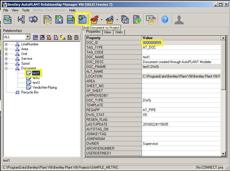

  11. Use Relation Ship Manager to move the drawing from your desktop to the previous location
The drawing is now is in the project with a new DOC_ID and it should not display the error when opening.

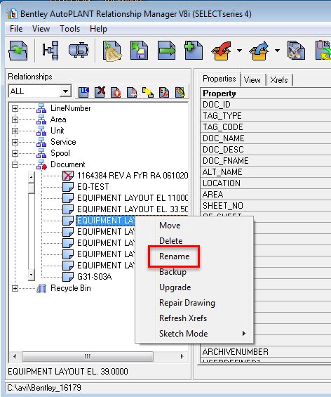

1. Open Relationship Manager.
2. Go to File> Open and select project.
3. Select drawing under document tab.

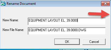

4. Right click on it and click on "Rename".

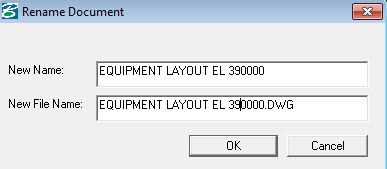

5. Remove dots or any special symbol from drawing name.
    Original drawing name : EQUIPMENT LAYOUT EL.39.0000
    Rename to :  EQUIPMENT LAYOUT EL 390000
6. same steps need to follow for other drawings.
