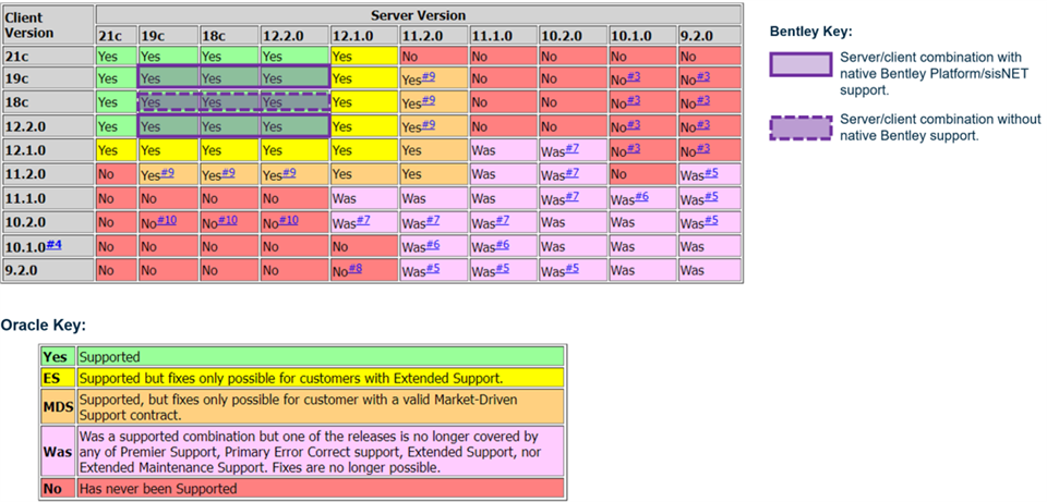

sisNET CONNECT Edition can be used with Oracle Server 12.2, 18c or 19c. The Oracle Client must always be 64 bit and can be of version 12.2 or 19c. These combinations are indicated in the purple rectangles in the matrix below. Combinations outside the purple cells are not supported by Bentley.
If you must use an Oracle 18c client, you need to copy and rename the Oracle 18 client DLLs to Oracle 12 client DLLs, see the note below. Keep in mind that the Oracle 18 client does not have formal Bentley support. Unsupported combinations may seem to work but can run into errors for some operations. The fact that they seem to work should not be relied upon. Bentley will not investigate issues on unsupported combinations.
Note that regular support from Oracle itself is only available for the server/client combinations indicated by the green cells in the overview. For yellow or orange cells in the overview, you need  additional support contracts with Oracle.
Note: In case you must use an Oracle 18c client:
 sisVIEW CE Update 5, 6 and 7 installations with Oracle 18XE are to be supplemented with an Oracle 19c client - this eliminates the above workaround of duplicating two DLLs. The sisNET > sisVIEW data exchange is done via the Projektverwaltung using EXP/IMP. A datapump data transfer from Oracle 19 to a lower Oracle version is currently not supported.
