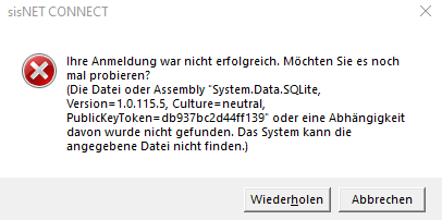

SQLite error message when starting sisManager, Projectverwaltung or sisNET IMB-Client
If, after installing sisNET 2023.00.01.03, the following error appears when starting the sisManager, the Projectverwaltung, or the sisNET IMB-client after attempting to log in:
apply then the following workaround: copy the file
c:\Program Files\Bentley\OpenUtilities sisNET CONNECT Edition\OpenUtilitiesSisnet\Assemblies\System.Data.SQLite.dll
to
c:\Program Files\Bentley\OpenUtilities sisNET CONNECT Edition\OpenUtilitiesSisnet\Assemblies\sisnet\
