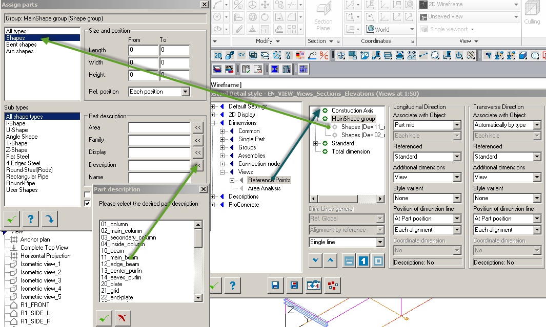

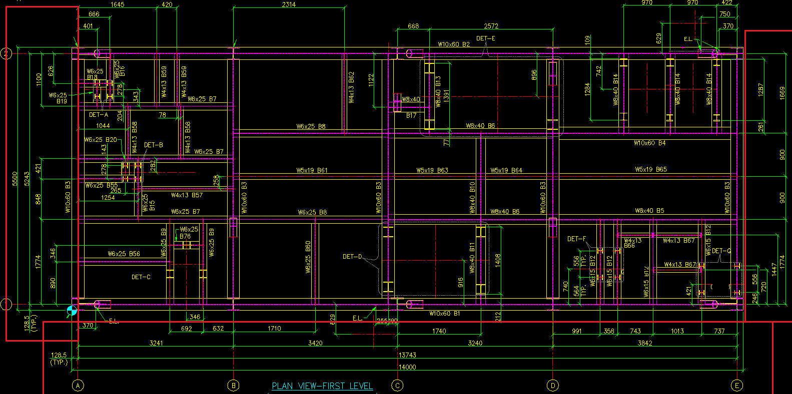

     I  want to add dimension of  GENERAL ARRANGEMENT OF  FRAME in Bentley pro structure v8i ss4 automatically. For your better understanding please see  attached snap(red box dimension) in these snap dimension are given manually .I want to add these dimension automatically.
Can anyone give me some tips to how to set these types of  dimension in pro structure v8i ss4 ( 2D DETAIL CENTER ) automatically.

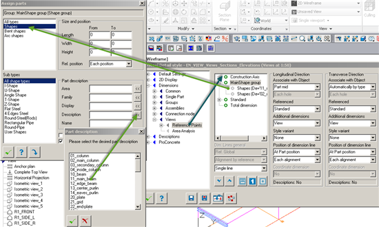

Solution: RE: How to set DIMENSION OF GENERAL ARRANGEMENT OF FRAME von Johannes Michalowsky
Hello,
In the Detailstyle in Views / Referencepoints Right Click add dimension points.
Special Group for constrcution Axis,
Add Dimension group for shapes, than add parts, there you can filter by description like main beam, main column for example.
