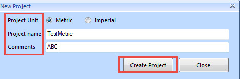

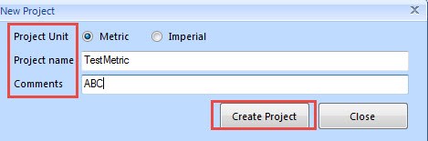

  3. Give Project Unit (Metric or Imperial) say Metric, Project Name say TestMetric and Comments (if any) say ABC in “New Project” dialog and press “Create Project” button

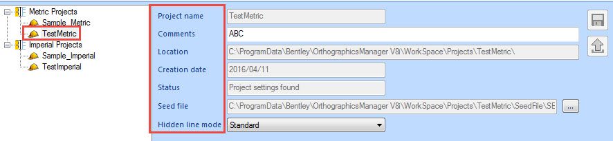

  4. New Project will be created in left side pane of OpenPlant Orthographics Manager Interface and all project information like Project name, Comments, Location, Creation Date, Status, Seed file location and Hidden Line mode will be shown in right side pane

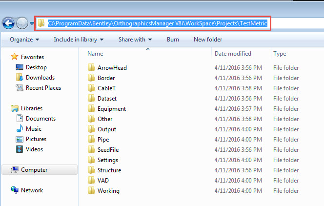

  5. Go to Project Workspace directory to see project created correctly with all folders (ArrowHead, Border, CableT etc.) “C:\ProgramData\Bentley\OrthographicsManager V8i\WorkSpace\Projects\TestMetric”
