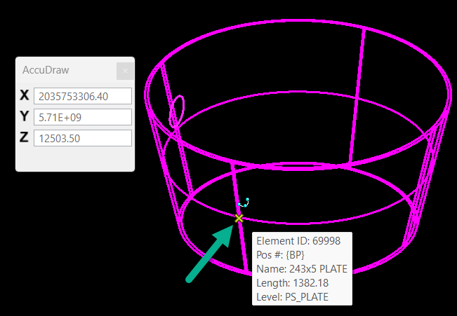

Currently, the object is far away from the global origin as you can see the dimension in the below image. This wiki explains how to move the objects to the global origin.

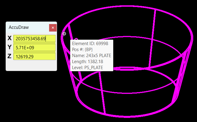

1. Select the object(s), hold right click and select the Move option.
2. Select the first point (or the base point) over the object.

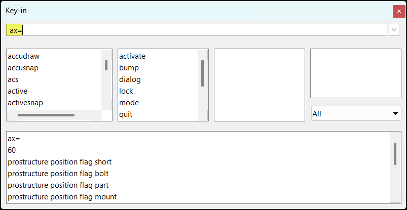

3. Open Key-in dialog and type ax= then hit enter.

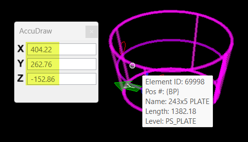

4. Now, right click to exit from the command. The object is now moved to the origin as shown in the below image.
In this way, one can move the objects to the origin.
