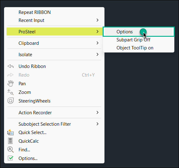

1. Open ProSteel Options by Right Click > ProSteel > Options.

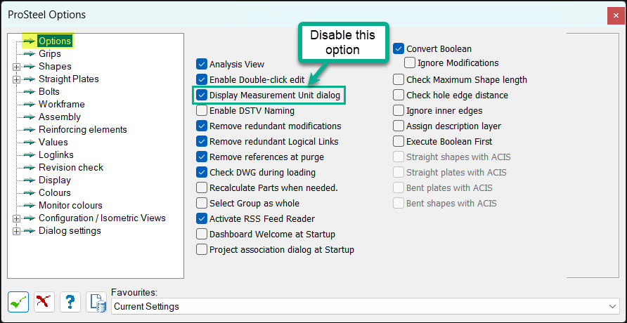

2. In the Options page, disable Display Measurement Unit dialog and click on the OK button.
