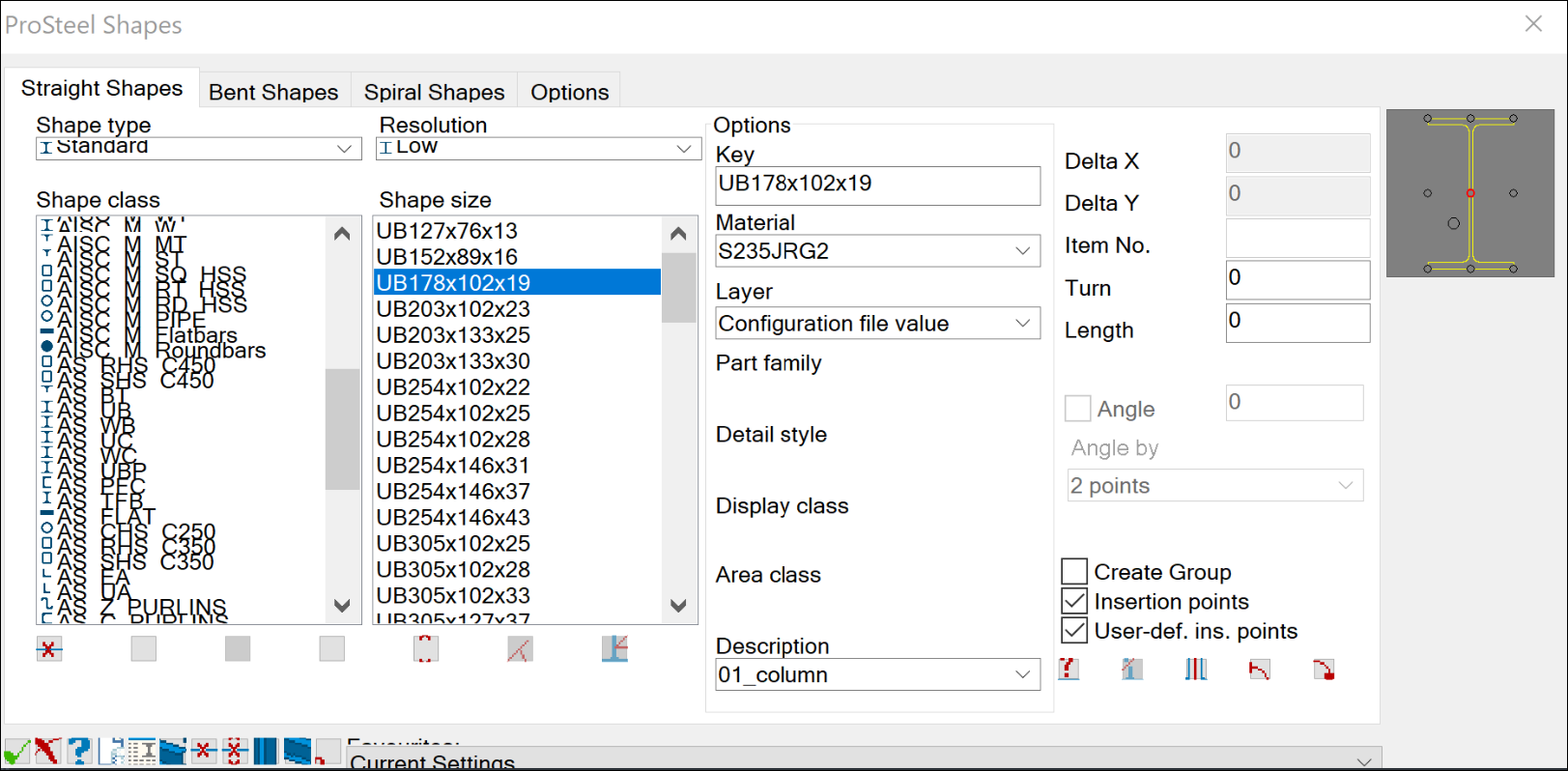

For the 4K monitor, the sub-menus of ProStructures are not correctly showing.

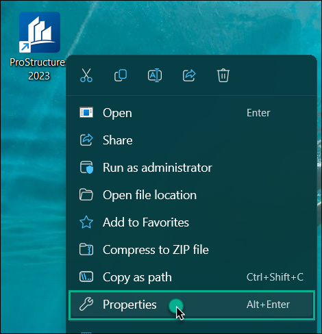

1. Open the Properties of ProStructures shortcut icon.

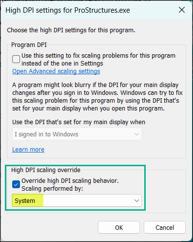

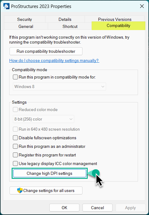

2. Go to Compatibility tab and click on Change High DPI Settings.
3. Enable Override High DPI Scaling Behavior and select the System from the dropdown then click OK.
4. Click the Apply and OK button.
