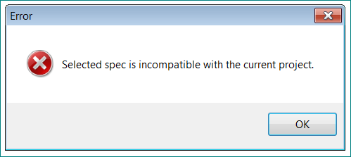

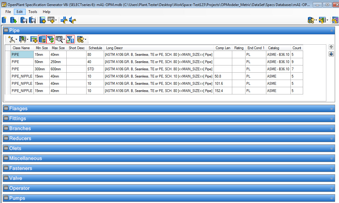

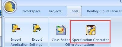

To Fix Error While Loading Specs via Specification Generator

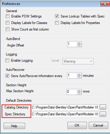

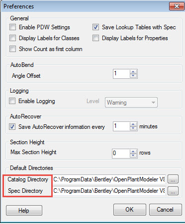

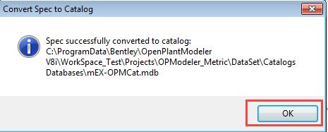

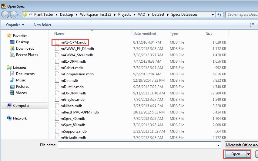

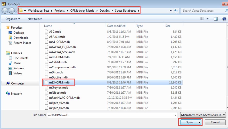

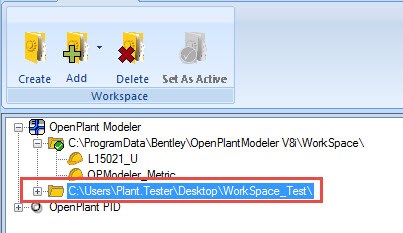

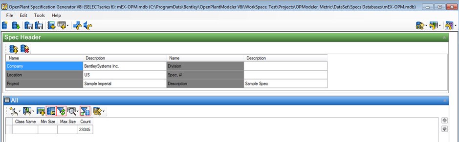

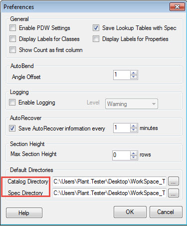

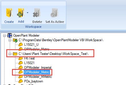

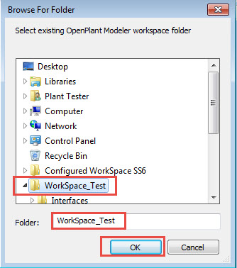

If we copy workspace folder at some external location and rename it with some other name than workspace for example “Workspace_Test”, than an error will pop up while loading specs in Specification Generator and specs will not be loaded.

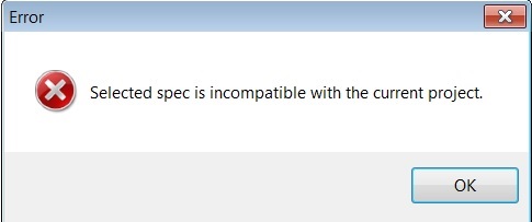

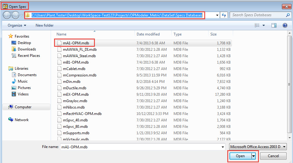

User copied Specs from Imperial and trying to Exchange specs in Specification Manager using Metric Project and getting same error,
