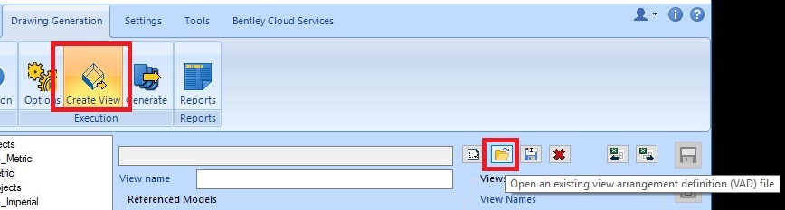

  2. Go to Drawing Generation – Create View
  3. Select Open already existing view arrangement definition (VAD) file from “Open” button

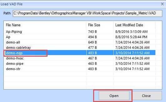

  4. Open a view arrangement definition file having single or multiple views from “Load VAD File” dialog
  5. The selected file will be loaded in OpenPlant Orthographics Manager

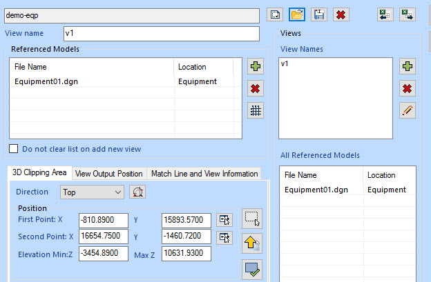

  6. Select the view(s) you want to delete from View Names

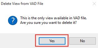

  7. Select “X” button
  8. Press “Yes” to Delete View from VAD File confirmation message
  9. Select view(s) will be deleted from view arrangement definition (VAD) file
