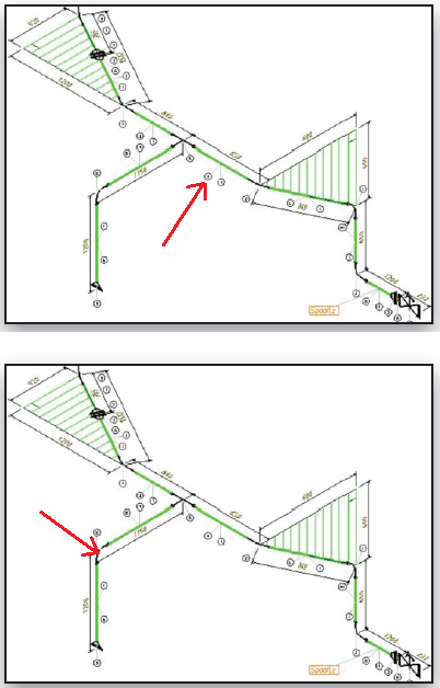

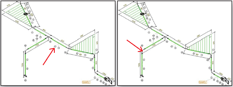

When generating an iso, how can we change the round point number "bubbles" as well as elbows, as shown below, to square instead?
  1. Open the custom.cel cell library in MicroStation (located in the \project\isoextractor\cell folder) by choosing Element > Cell.
  2. Import these two cells from lisocomp.cel: "90BW" and "POSNUM".
  3. Change the layout of the cells as needed using MicroStation modification tools, leaving the construction mode connect points of 90BW untouched.
