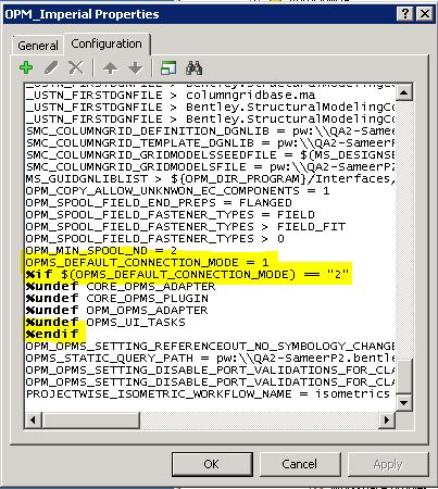

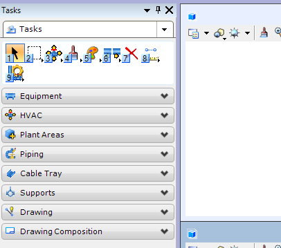

Setting up new managed workspace environment with Projectwise CONNECT Edition and OpenPlant Modeler , immediate observation is all the OpenPlant ModelServer tools are missing. Login prompt, Tree or task pane items.
This is related to bug in Projectwise CONNECT Edition import which disables any conditional statement in configuration files. Going to Projectwise Administrator and checking configuration you would see the following.
If above problem still persist, then please create a Service Request and contact the Bentley Product Advantage group. Please include a list of all relevant details to get in depth analysis for a solution or workaround.
