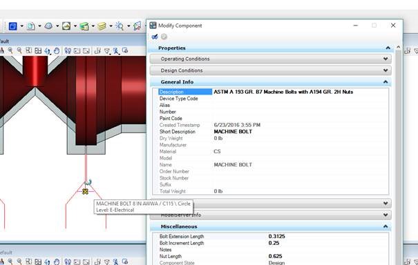

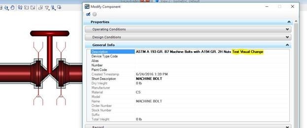

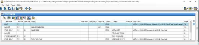

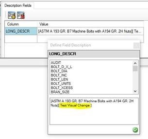

When running Spec Validation Tool, some spec driven objects do not update properly. This may happen when any revision done. Below are a list of steps to alter the description of any spec driven component.
communities.bentley.com/.../29496.how-to-update-bolts-and-gaskets-in-openplant-modeler
