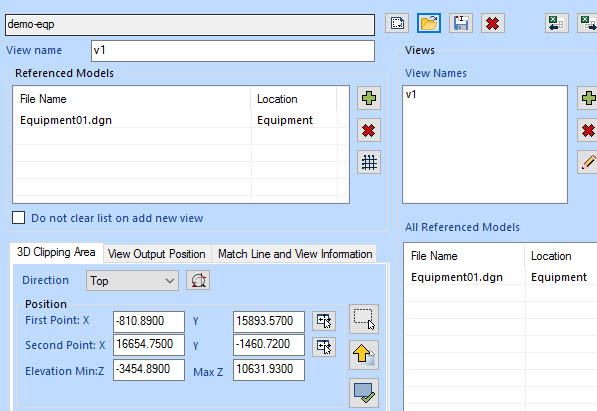

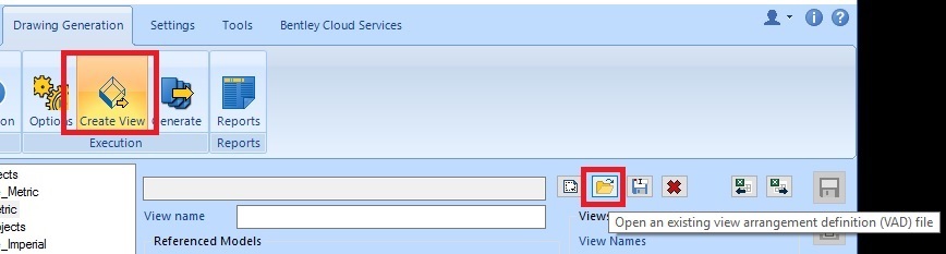

  1. Launch OpenPlant Orthographics Manager and select a project
  2. Go to Drawing Generation –-> Create View

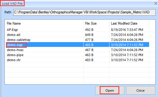

  3. Select “Open an existing view arrangement definition (VAD) file” from “Open” button

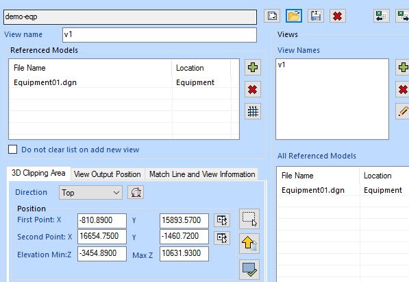

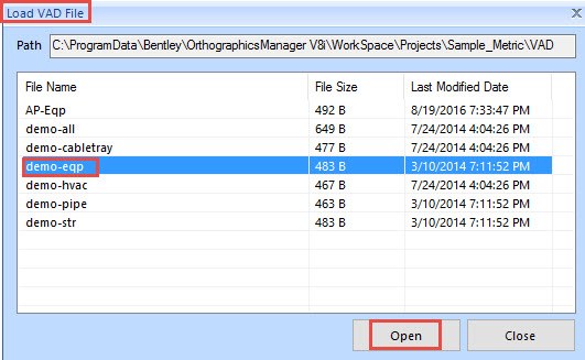

  4. Load a view arrangement definition file to “Edit” from “Load VAD File” dialog
  5. The selected file will be loaded in OpenPlant Orthographics Manager

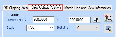

  6. Go to “View Output Position” tab

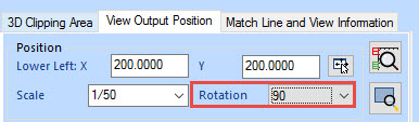

  7. Change the angle to desired one from “Rotation” drop down say change it to “90”

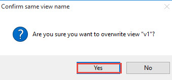

  8. Save the changes by pressing save button
  9. Press “Yes” to “Confirm same view name” confirmation pop up message

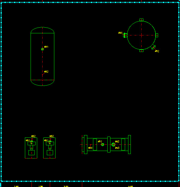

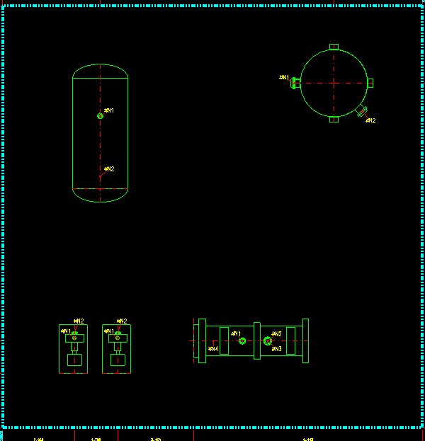

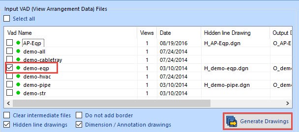

  10.  After saving, go to Drawing Generation ---> Generate
  11. Select a View Arrangement Definition (VAD) File in which rotation angle is defined by clicking the box and press “Generate Drawings” to generate output drawing
  12. Confirm that angle in changed to selected one (90 degree in this case)
