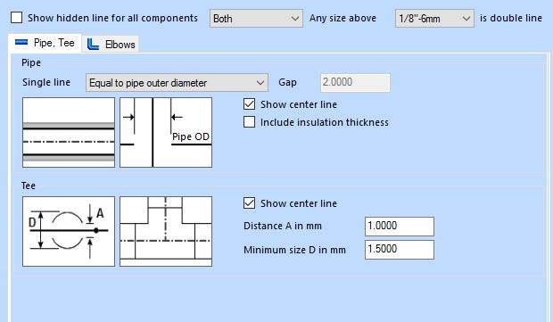

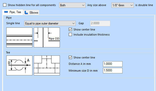

To Show Hidden Components in OpenPlant Orthographics Manager's Output Drawing

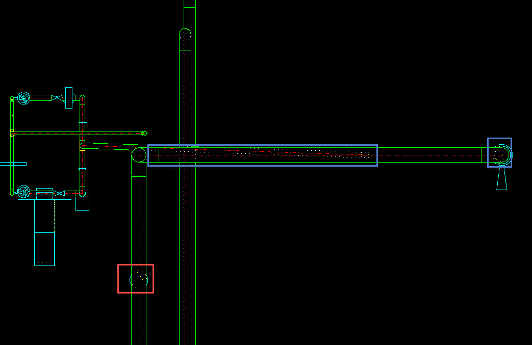

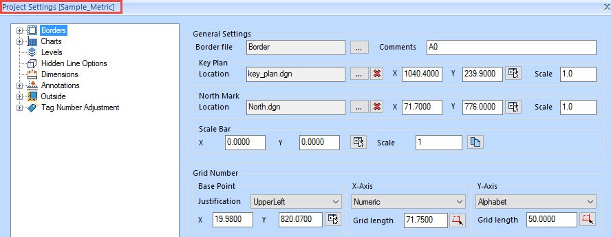

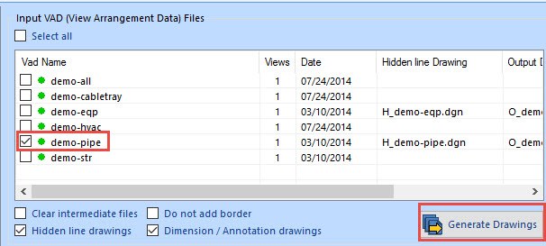

In OpenPlant Orthographics Manager, sometime some drawing model components hide behind the other components while defining X,Y co-ordinates for a view. But actually they are a part of a View in view arrangement definition file. User has the option to show hidden lines for such components in OpenPlant Orthographics Manager's Output Drawing.
