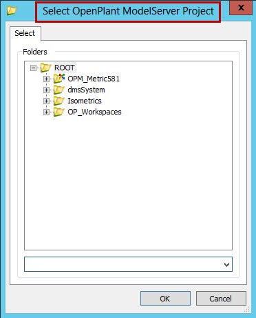

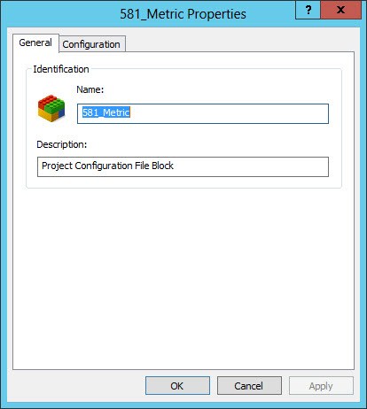

While launching OpenPlant Isometrics Manager with Projectwise managed workspace below dialog shows up for selecting OpenPlant ModelServer Project.

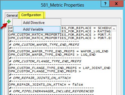

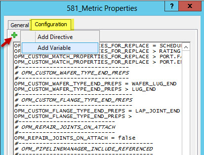

If user doesn't have model server project, they can suppress this dialog by one setting in managed workspace.

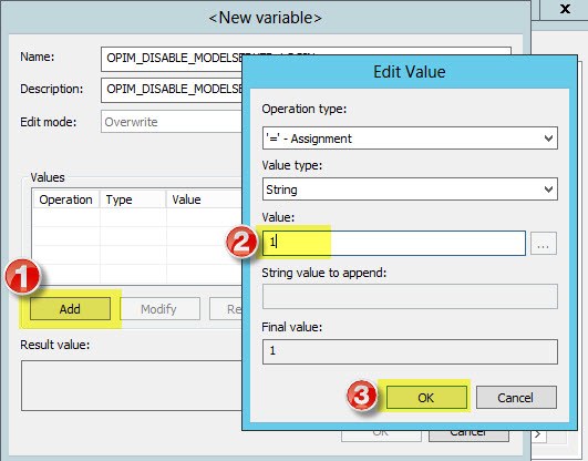

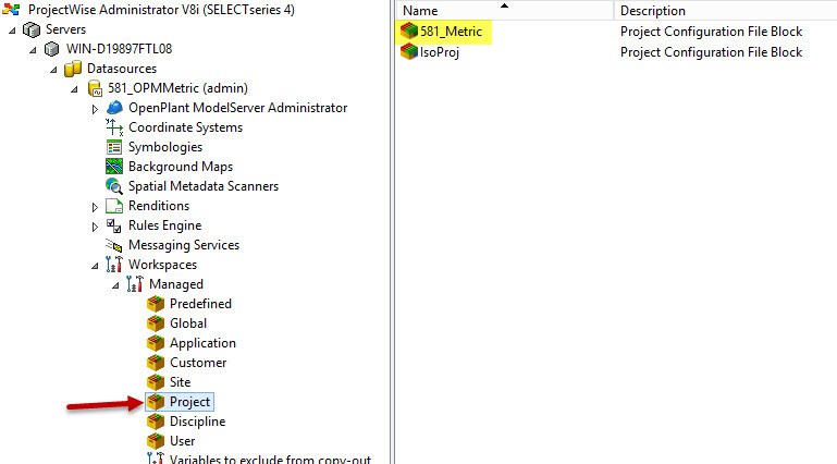

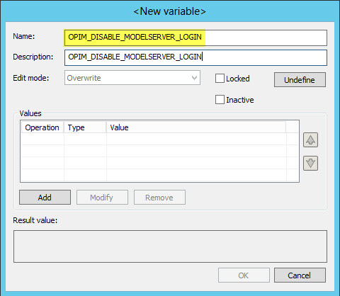

Setting the Variable in Project CSB

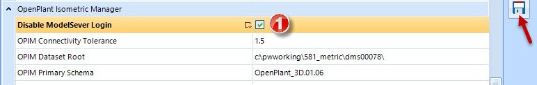

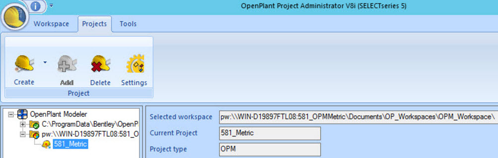

Setting in OpenPlant Project Administrator
