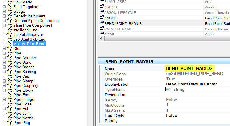

  1. Open class editor and load OpenPlant_3D schema.
  2. Supplement OpenPlant_3D_Supplemental_Modeling and OpenPlant_3D_Supplemental_Metric_DefaultValues with it.

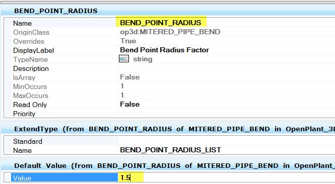

  3. Go to MITERED_PIPE_BEND class and select Bend Point Radius Factor property.
  4. Change the value field in Default Value custom attribute as highlighted.

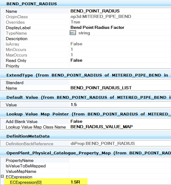

  5. In OpenPlant_Physical_Catalogue_Proeprty_Map custom attribute change the value 3R to 1.5R.

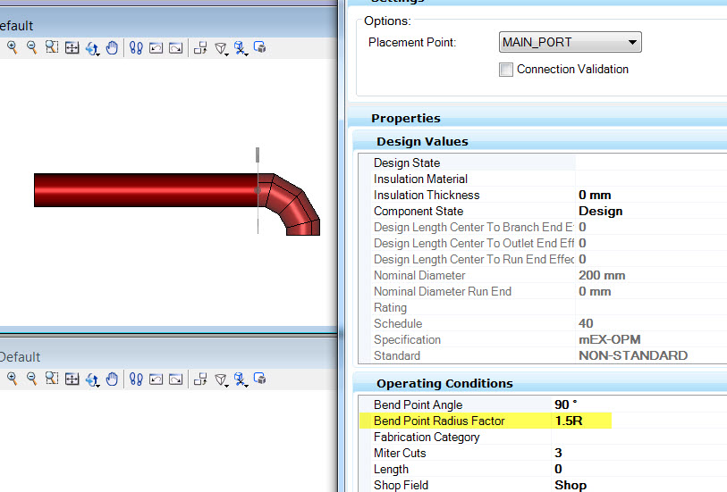

  6. Verify the result in OPM.
