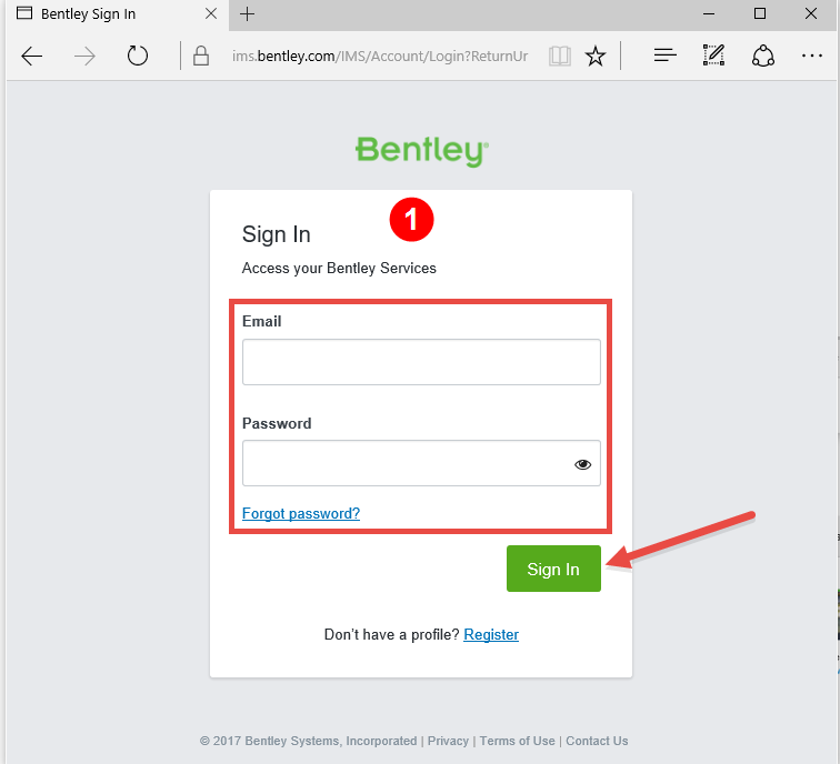

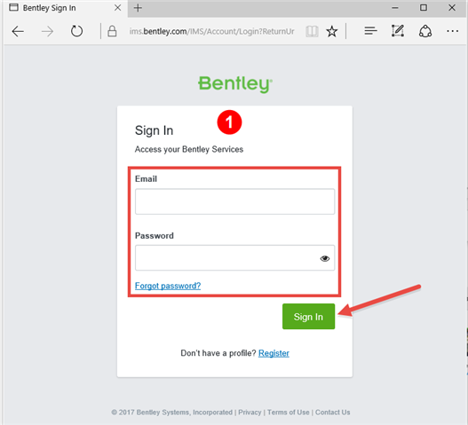

1. Log in to the Bentley Fulfillment Center here:  https://select.bentley.com/FulfillmentCenter

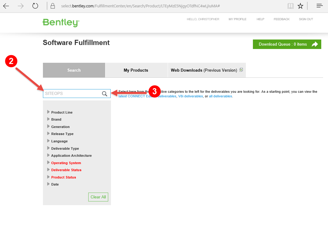

2.  In the search toolbar, type “SITEOPS”.  Note: You might need to Clear All previous search criteria to see all SITEOPS products.
3.  Click the magnifying glass, search icon

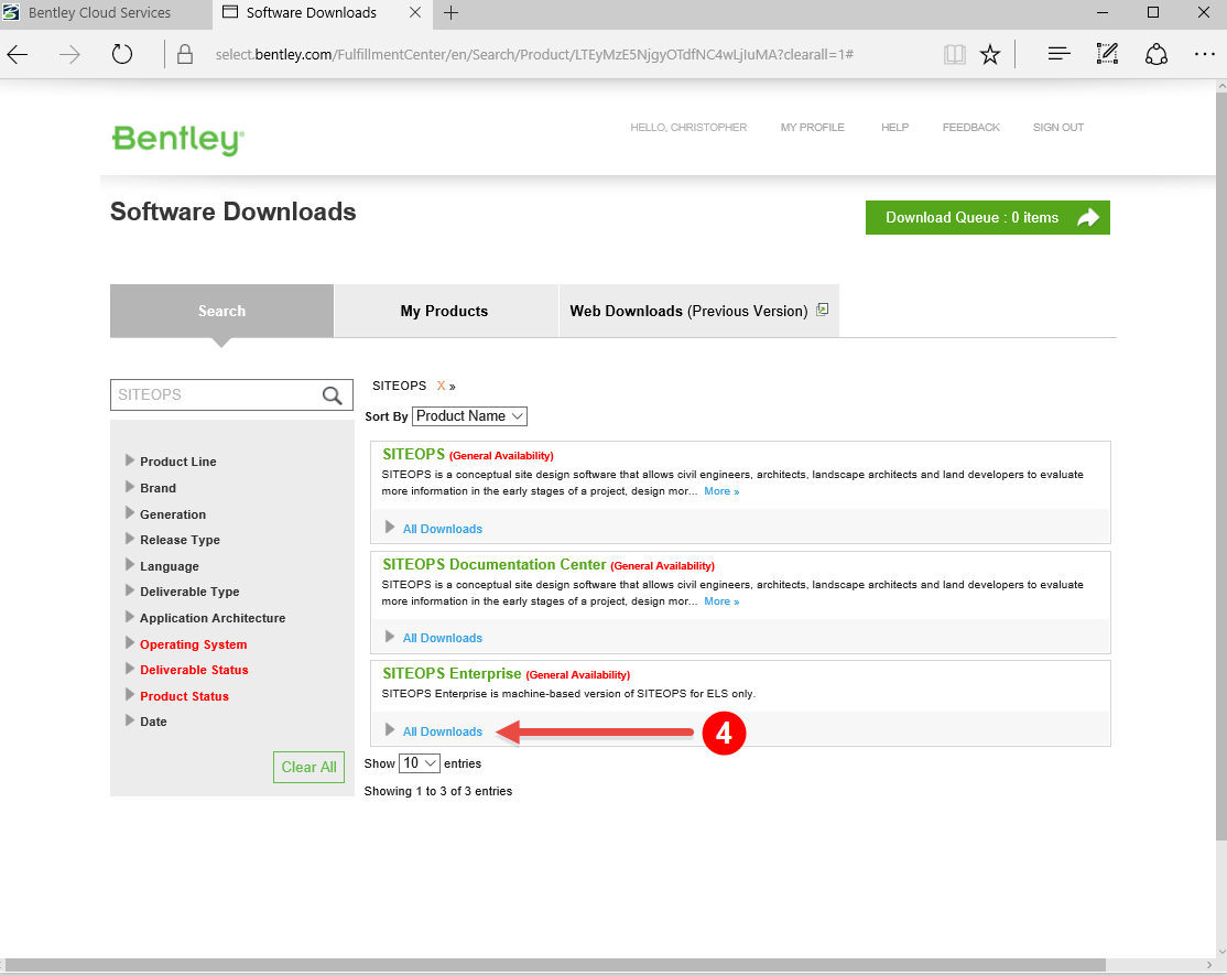

4. Click All Downloads under the SITEOPS Enterprise (General Availability)

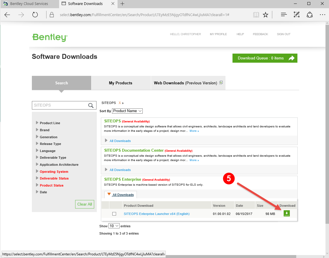

5. Click the green download button for the SITEOPS Enterprise Launcher. This will download the installer.
