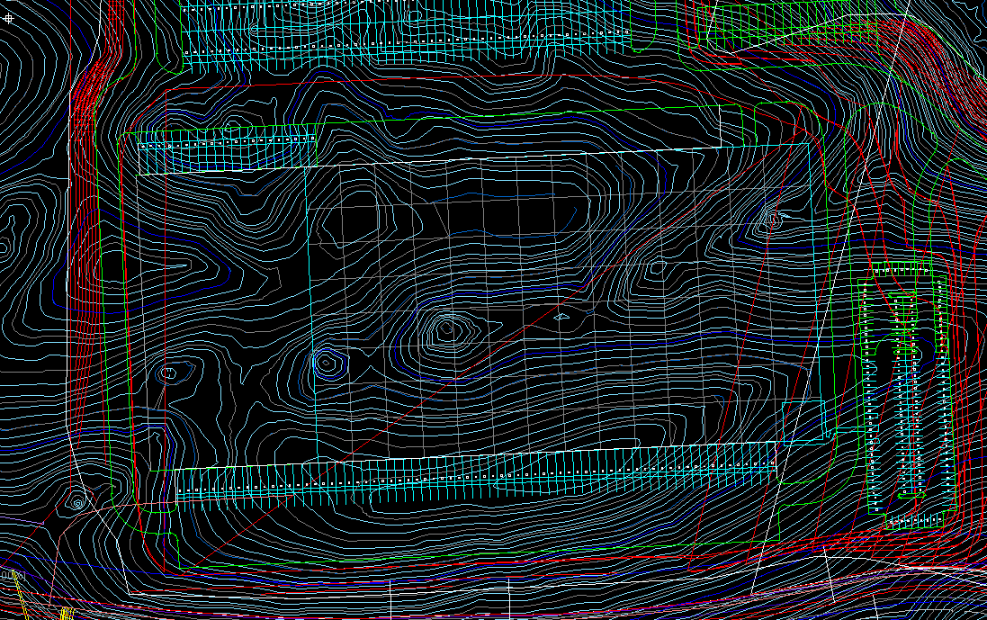

Import 2018 DWG file
The Import file can be used to import a variety of files into SITEOPS, this release update now has support for DWG 2018 format.

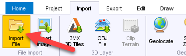

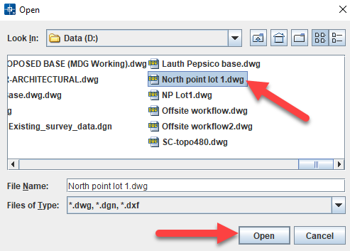

1. Click the Import File icon from the Import tab

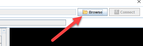

2. Click Browse button to locate desire file to import
3. Locate desired file then click on it once with left mouse button, next
click Open button to select DWG file for use

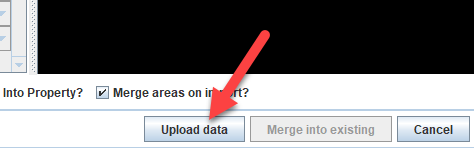

4. Click Upload date button, this will compile data for use in SITEOPS

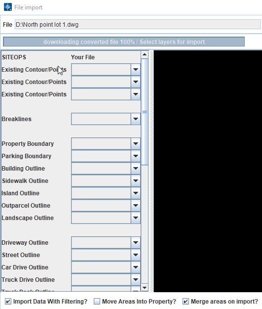

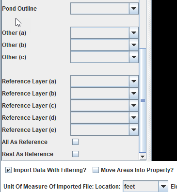

5. Either map DWG layers to SITEOPS components or bring in as reference.

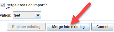

or
6. Next click Merge into existing button to bring data into SITEOPS.

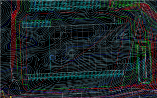

7. Your DWG data will then in SITEOPS and ready for use
