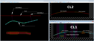

When used, it does project the vertical intersection points of the source profile to the target horizontal, perpendicular to the target alignment.
In the following picture you can see CL2 profile projected onto CL1.
GeomBL1 and GeomBL2 are controlled points used for CL2 Vertical Intersection Points  to highlight how it is being done.
You can see how GeomBL1 and GeomBL2 are also location of projected profile on CL1.
It means that slopes can be changed even if horizontals are parallel.
