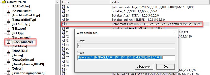

Below you can see an entry for a concrete mast.
4=Betonmast,1,BMTRAG,1,1,0,1.25,1.25,1.25,1.25,dbft089,MZ,2.5,1,0,99
4 is the number entry that will represent this cell in other parts of the program. We can see what the entries are using the above parameter definitions.

Do Not Use |
dbft089,MZ,2.5,1,0,99 |
These parameters are for compatibility only and not needed in OpenRail Overhead Line Designer. |
