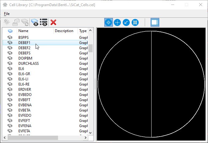

We will use an existing cell definition, “DEBEF1”, from existing “SiCat_Cells.cel” library for this example. You can create your own cells or import existing ones. Please refer to MicroStation trainings and documentation for more information about creating cells.

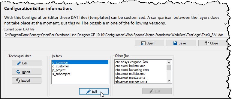

2- If you decide to work on active dat file then close the OpenRail Overhead Line Designer beforehand. Or else program will override the changes you have made in the file, as this is the working file.

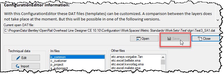

3- Open DAT File
Run Configuration editor and open required dat file. In this example we will use to active dgn.dat so the new definition will be available immediately.

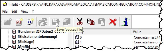

4- Open INI file for editing
        Select o_common.ini file and click Edit
 Register new cell definition to Blocksymbole section.

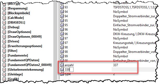

5- Select Blocksymbole from the sections list. In this step you can either use New entry tool to create a new entry or use an existing similar entry and copy and paste. To copy an entry right click on the entry and select Copy.
We will use New entry button to create a new entry. In the library there are 337 definitions, so this new entry should have the next available number, 338. Name the new entry as “338”. Please note you can see number of entries by checking “anzahl” (number) entry .

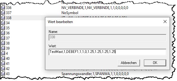

6- Add new values to entry
Double click on the newly created entry and add required values and click OK.
TestMast,1,DEBEF1,1,1,0,1.25,1.25,1.25,1.25
Please refer to “Cell Settings in INI Files” chapter for definition of these values.

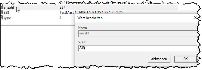

7- Increase “Anzhl” entry to match with new number of entries.
Double click Anzhl entry and change value to 338.

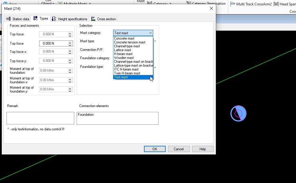

Name of the new entry is “10” as there are already masts defined from 0 to 9 in this section. We will name new mast as “Test Mast” and want to have backstay anchor to be applied in wire termination (“J”). We will use the newly registered cell definition “338” for the representation of this new mast in the plan view.
So the value will be;
Test mast,J,338
9- Increase “Anzhl” entry of this (Maste) section to match with new number of entries.
Double click Anzhl entry and change value to 11 (note that there is a definition using number 0 so total count is 11).
10- Save the INI file and close ini editor.
11- Save the DAT file and close DAT editor.
12- Start OpenRail Overhead Line Designer and open the project dgn. You can see new type is added to mast type list and represented with defined cell. Please note that if you added definition to one of the library DAT files (Common, your active project dgn will not be affected. However, all new projects will include the new definition.
