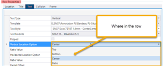

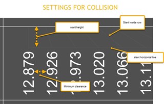

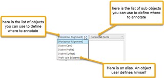

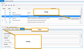

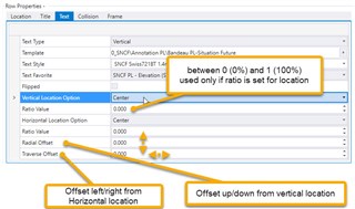

Some few indications on setting up frame annotation definition.
For each frame:
Location:
How:
The margins define a vertical offset from the vertical margin that is used to control the uppermost and lowermost position of the alignment or profile schematic.
