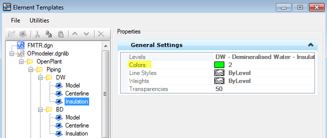

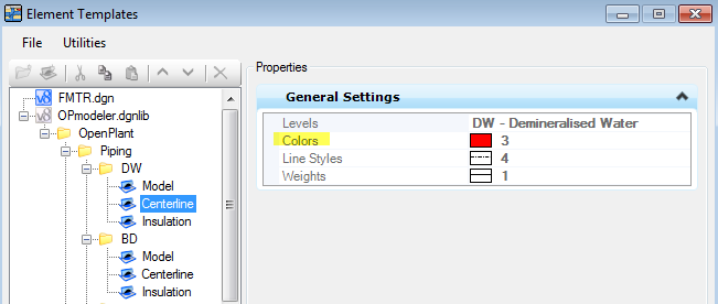

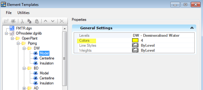

  2. In menu select Element -> Element Templates.
  3. Browse to OpenPlant -> Piping section, see what templates are already available. If required create new services:
  4. Set symbology as per requirement. See below has been set for few existing Services.
    For Model:
    For Centerline:
    For Insulation:

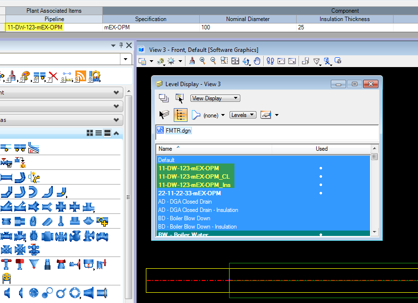

  5. In menu open Utilities -> Named Expressions. Here for Pipelines, it is required update 3 expressions:
    OP_SYMBOLOGY_PIPING:
    "BY_LEVEL_AND_TEMPLATE:" & PIPELINE.NAME & ":OpenPlant\Piping\" & PIPELINE.SERVICE_NAME & ":Model"
    OP_SYMBOLOGY_PIPING_CENTERLINE:
    "BY_LEVEL_AND_TEMPLATE:" & PIPELINE.NAME & “_CL” & ":OpenPlant\Piping\" & PIPELINE.SERVICE_NAME & ":Centerline"
    OP_SYMBOLOGY_PIPING_INSULATION:
    "BY_LEVEL_AND_TEMPLATE:" & PIPELINE.NAME & “_Ins” & ":OpenPlant\Piping\" & PIPELINE.SERVICE_NAME & ":Insulation"
  6. Save Expression and close the dialog box.
  7. Save and close the DGNLIB file.
  8. Launch OpenPlant Modeler and verify results with working DGN file.
