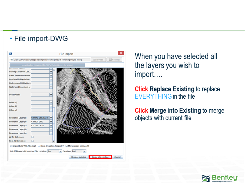

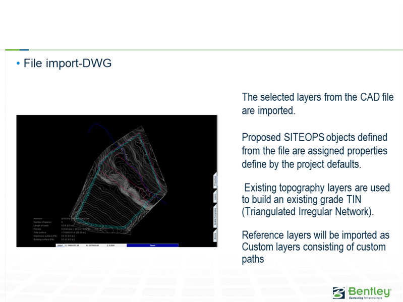

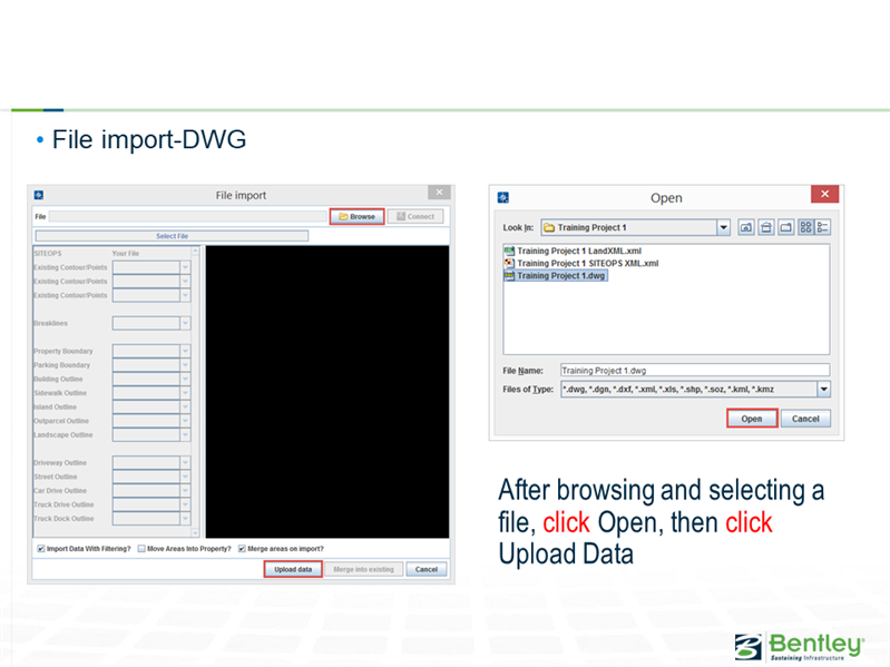

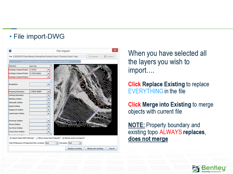

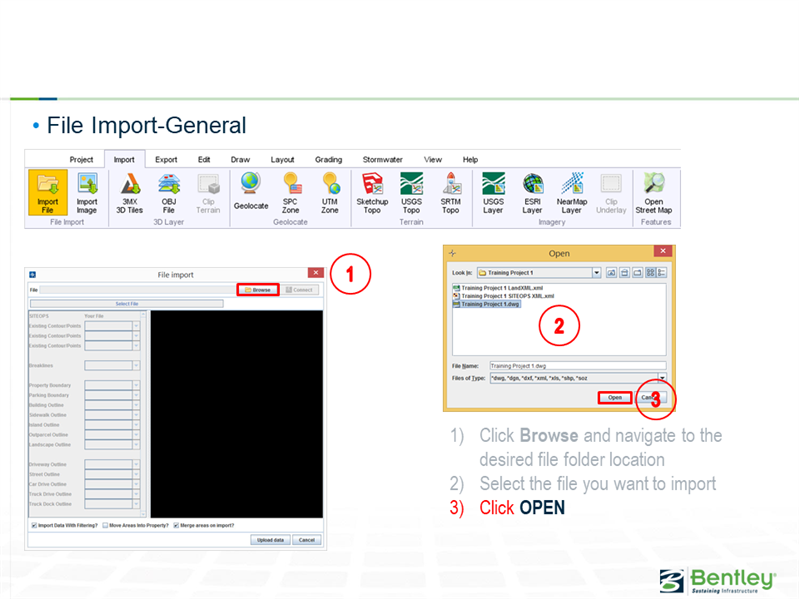

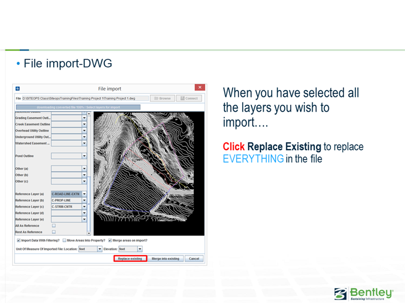

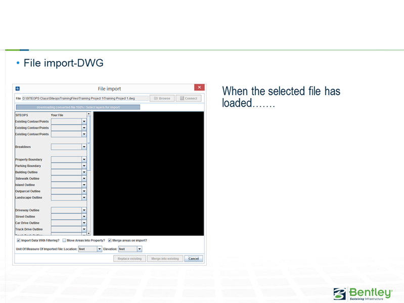

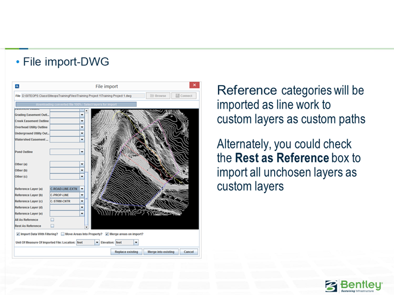

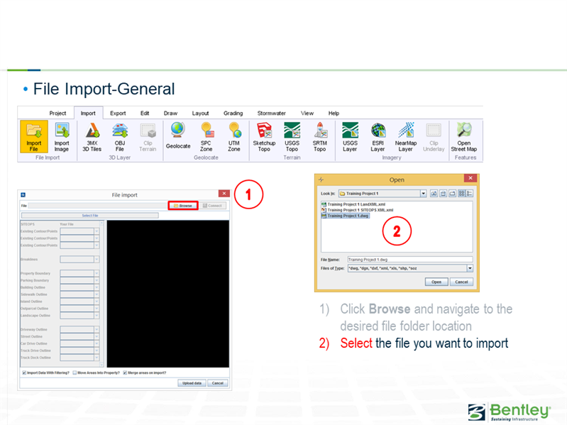

To continue and data from a DWG file:

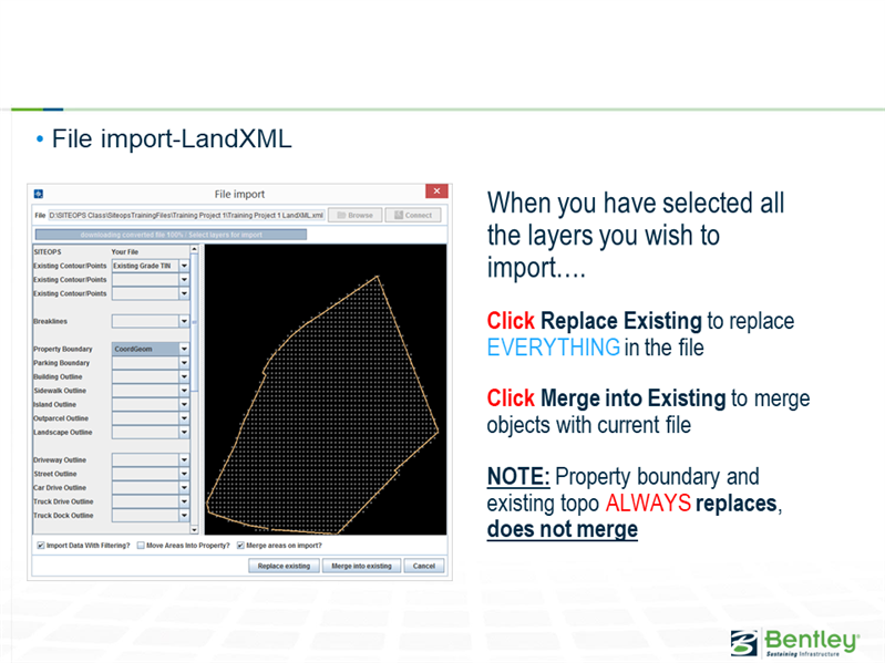

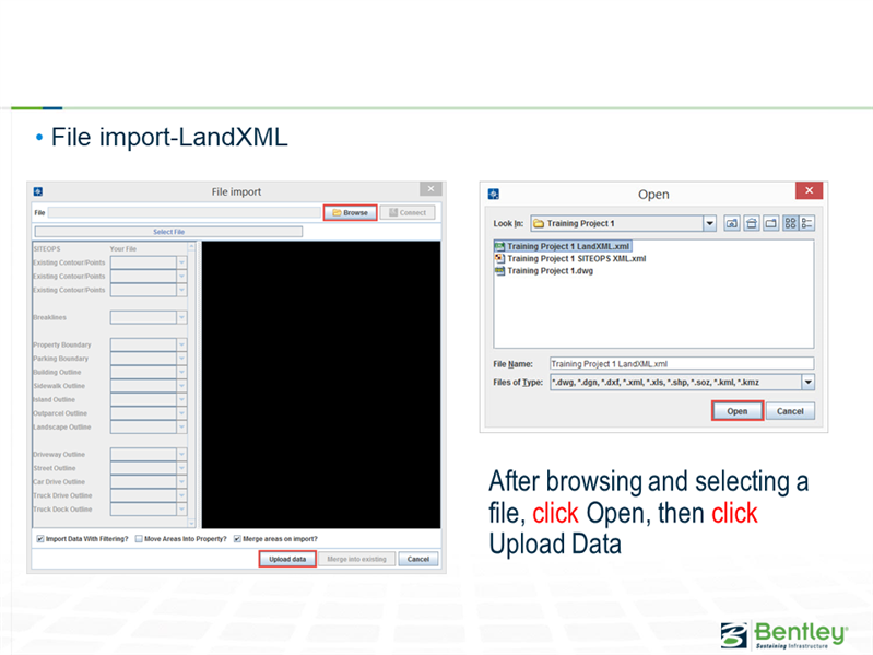

To continue and data from a LandXML file:

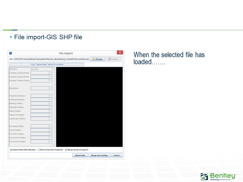

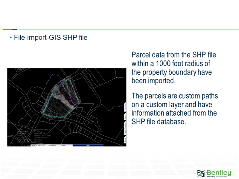

To continue and import data from a SHP file:
