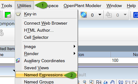

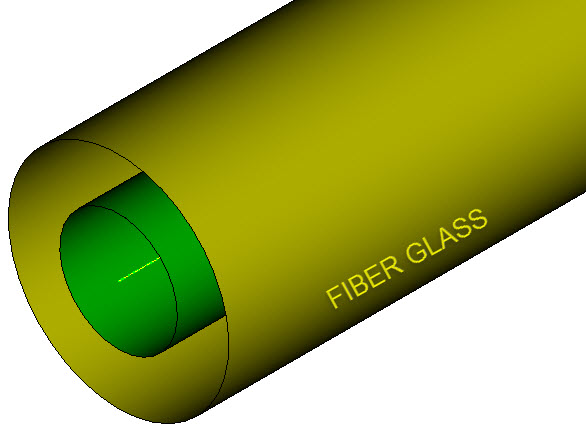

To set Insulation Symbology Based on Insulation Material using Named expression in OpenPlant Modeler.

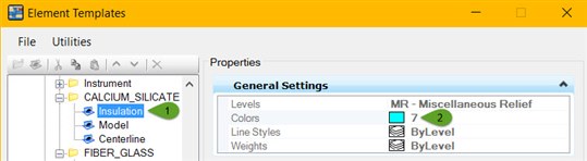

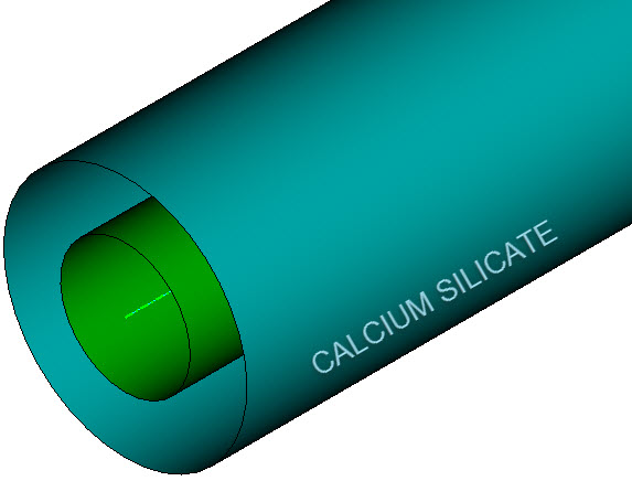

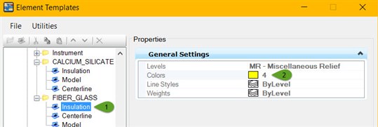

OpenPlant component symbology is managed in the typical MicroStation fashion. It is controlled through a combination of Named Expressions (used to read attributes and assign the Element Templates accordingly) and Element Templates (where symbology is defined for the elements identified by the Named Expression). For defining symbology based on Insulation Material, below are the steps to follow.
"BY_LEVEL_AND_TEMPLATE:" & PIPELINE.NAME & ":OpenPlant\Piping\" & OPITEM.INSULATION & ":Insulation"
