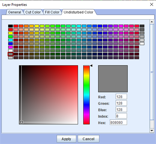

To access the layer settings, click the Properties Icon:
The following settings can be used to customize the grid design on the General tab:

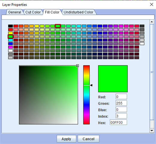

The following Colors can be set:
Cut Color – The color to use for the Location Marker and Depth text designating cut locations
Fill Color – The color to use for the Location Marker and Depth text designating fill locations
Undisturbed Color – The color to use for the Location Marker and Depth text designating undisturbed locations
