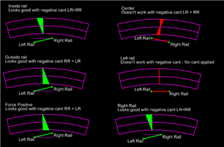

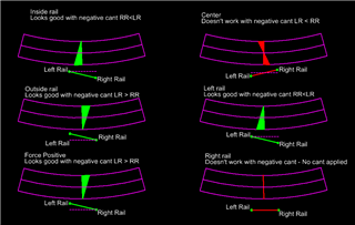

It happens that you must use negative cant.
Some defects have been identified in version 2020-R1 (10.08.00.88) and previous. For Latest version see Force Positive.
Here are the highlights for 2020-R1
- When Rotate About is set to Center: It doesn't work - Even you enter -100mm it is used as 100mm
- When Rotate About is set to Left Rail. It doesn't work on right hand curve - no cant applied
- When Rotate About is set to Right Rail. It doesn't work on left hand curve - no cant applied
Of course defect has been logged to fix these issue in further release.
