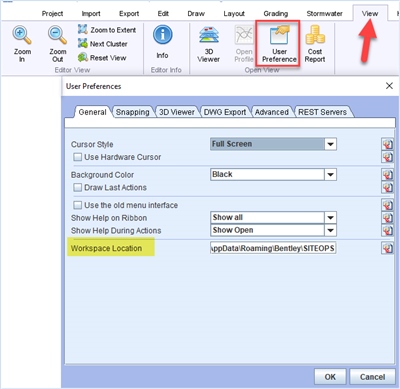

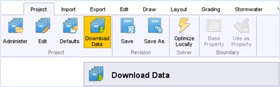

Once you open OpenSite SITEOPS, then you should be able to click the Download Data button  on the Project tab, see image 3 below.  This ONLY NEEDS TO BE DONE ONCE. All the data will be downloaded to the Workspace Location, which you can see in the User Preferences, see image 4 below.  Once the data is downloaded you will access the project/revision the same way as you did before. You can also move the data anywhere and point to it on each users machine by changing the Workspace Location.
