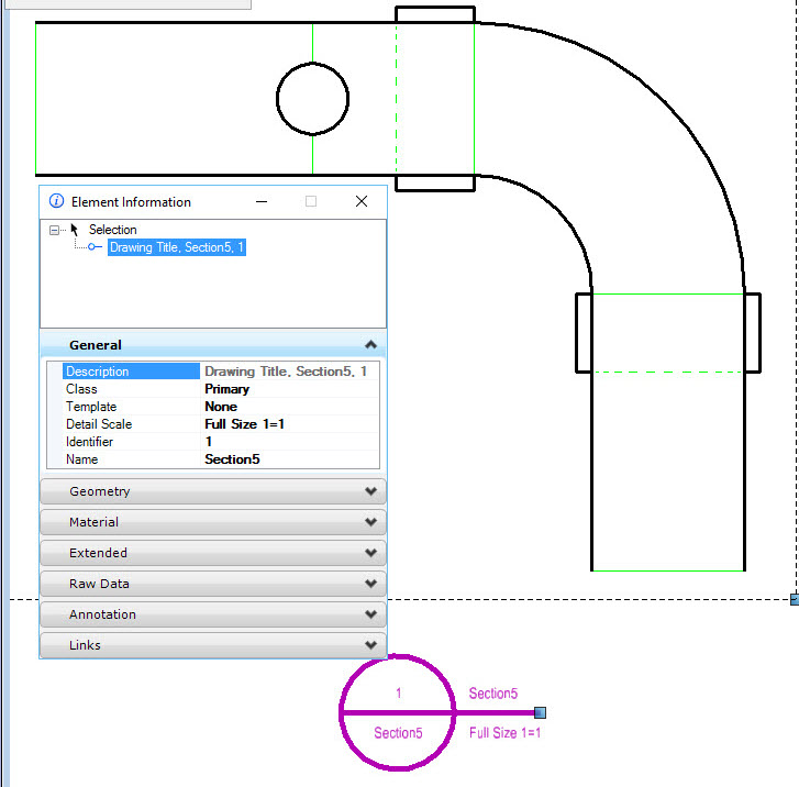

In OpenPlant Modeler there is a possibility to place Section Views and Callouts to identify a section view on a Sheet Model.
Below you will find steps how to place Section Callout in your model.

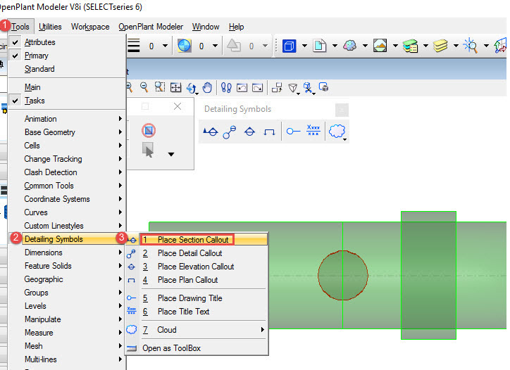

  1. Open your model in OpenPlant Modeler and set View Rotation from which you would like to place Section Callout.

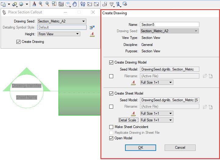

  2. Click Tools>Detailing Symbols>Place Section Callout.

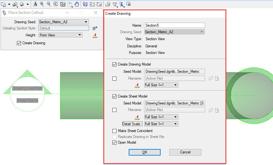

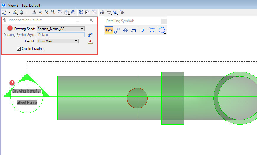

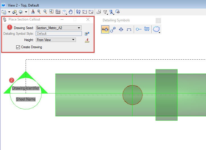

  3. In Opened dialog select Drawing Seed and then place a Section Callout
  4. Then Drawing Creation dialog will open and you will be able to sett required settings for Drawing and Sheet models

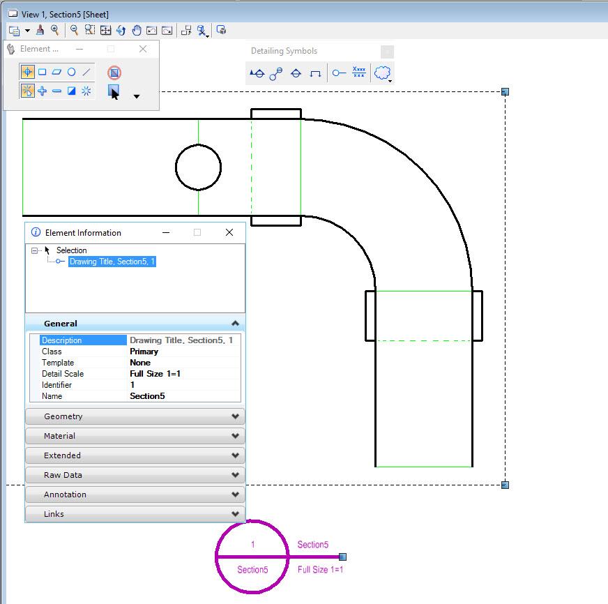

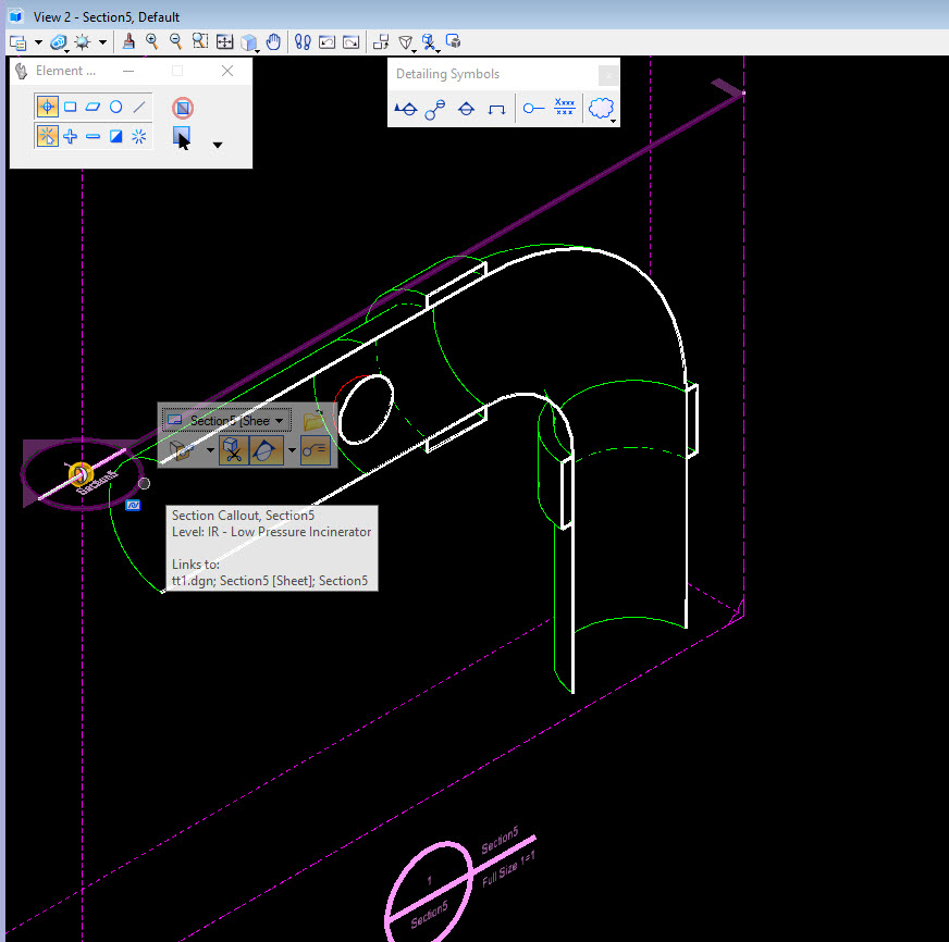

  5. After accepting with these settings a newly created Sheet model will be opened right away

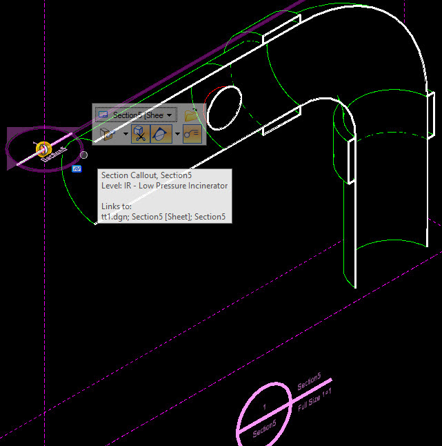

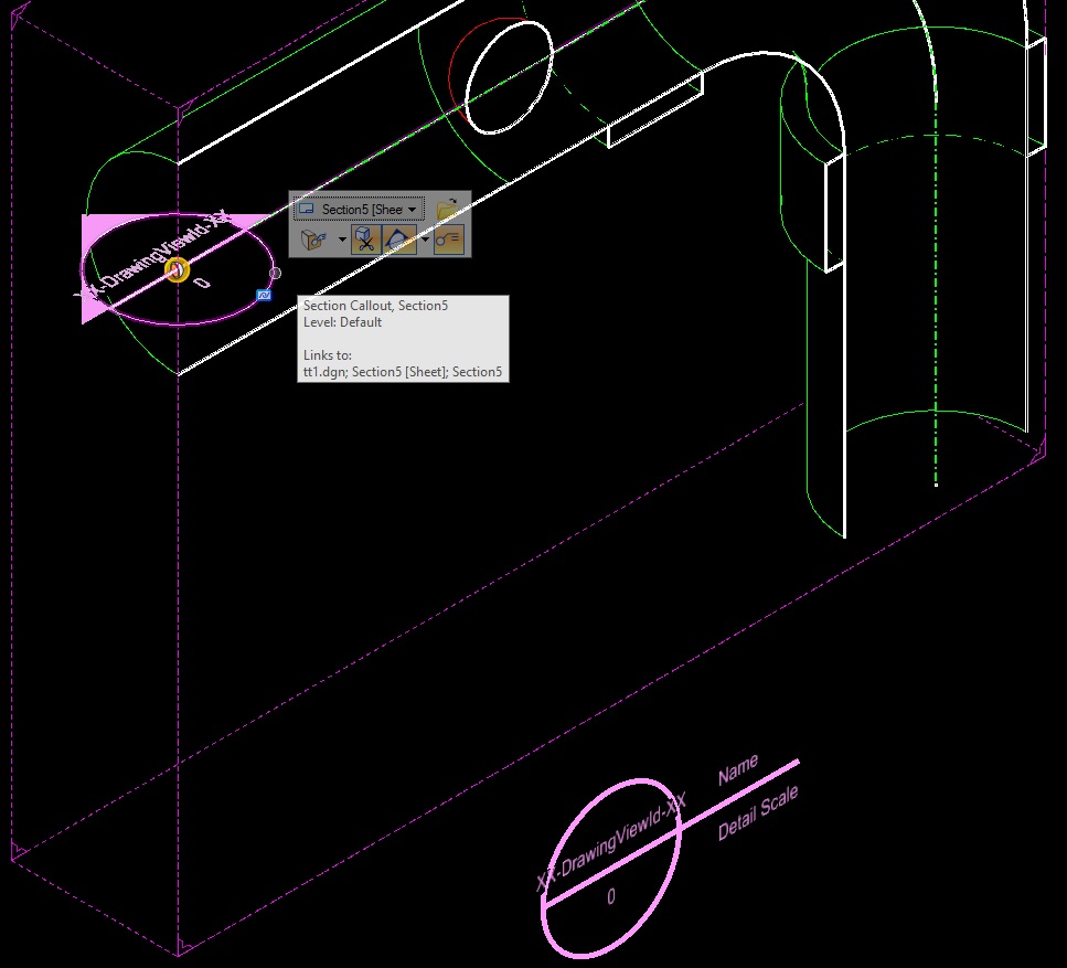

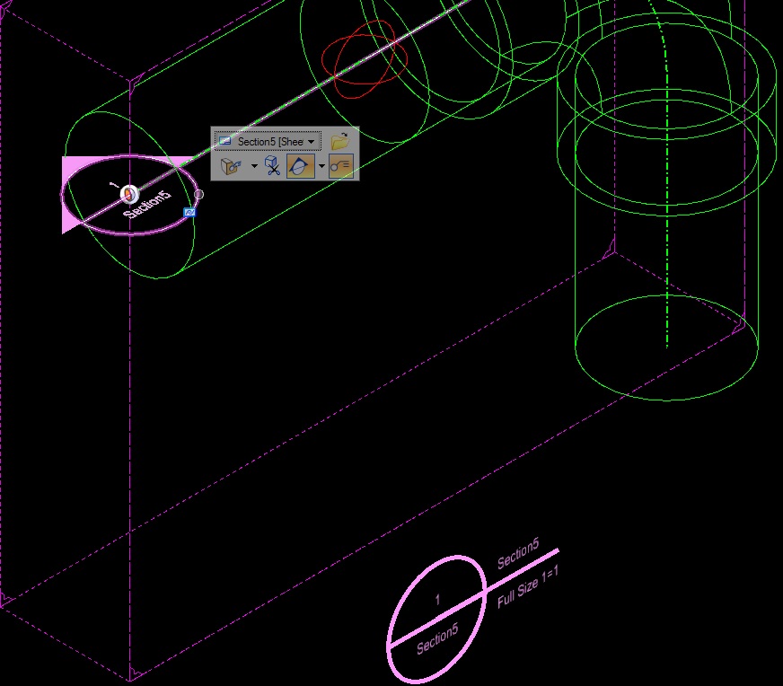

  6. Open your Master Model in Isometrics view and verify the results.
