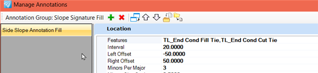

- set linear 3D annotation group that will be assigned to top feature definition
The annotation group is defining target features (possible bottom of slope from top feature) and style - assign this annotation group to top feature defintions

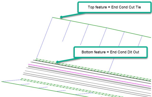

- Simple case where it is easy to identify top and bottom

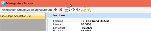

Linear 3D annotation group must be assigned to End Cond Cut Tie. It looks for End Cond Dit out

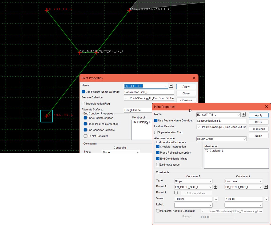

- "Complex" case
Cut and Fill are creating single Construction Limit_L feature
You don't know the feature definition that will be used. It depends on the first one created, cut or fill
Here, Fill 3D Linear annotation group must be assigned to Rail_Subballast feature definition seeking End Cond Fill Tie and End Cond Cut Tie as bottom features.
Cut 3D linear annotation group must be assigned to both End Cond Fill Tie and End Cond Cut Tie seeking End Cond Dit Out as bottom features.
