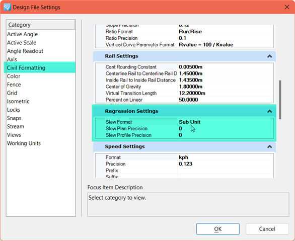

How to change Slew/Lift unit and signage (2023 and higher)

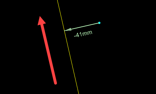

Slew Signage
REGRESSION_SLEW_RELATIVE_TO_POINT=1
Note that this variable is not set by default. You must add it to one of your configuration file.
You may add it in _Civil Default Standards - Metric.cfg (or imperial) or in your organization configuration file.

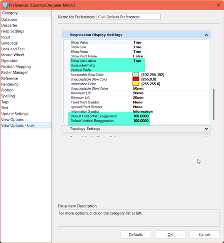

Regression Settings
